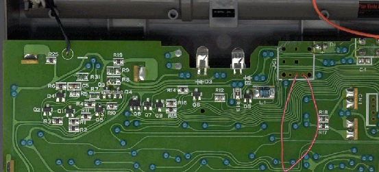

Q3 and Q4 2sc2712 (standard Replacement : BC 547)
Yes they are clear 5mm
Please note if you do not have the 3,5mm Jack control S connector.
A wire-bridge has to be made between two points which are normally covered by the 3,5mm Jack control S connector.
see the attached pic thin red wire.
 Filesize:  150.31 KB
 Viewed:  2809 Time(s)
Regards Halo1963

Thank you very much for your information, but i did add q3, q4 with transistor 2N2222 with Ic of1000ma and two black ir led transmitter from radio shack and jump that normally close jc1 and it's work fine i can control it like 10 meters away. I did it 3 days ago before i got your information.
