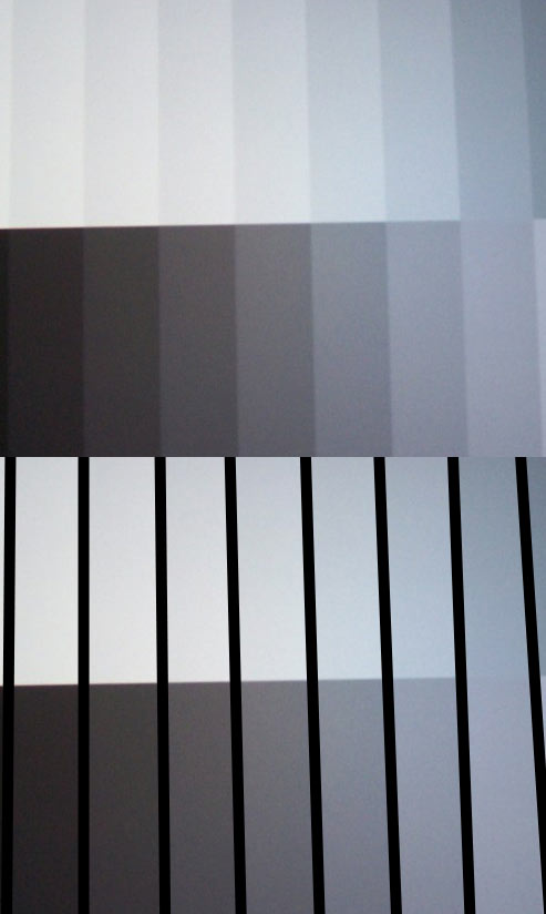

So here is another problem that has surfaced on my nec 6pg xtra.
There is (or looks to be) something like an edge enhancement problem. Not sure what else you would call it.
There is a slight shadow to the right of everything. It happens on all 3 tubes.
When I put up bars, you can see the bars are not solid. They seem to go from light to dark.
This problem shows up using the ps3 and hd-dvd xa2. There is also a vp50 and pioneer avr in the video path. We removed the vp50 and avr and ran stright from the ps3 and xa2 but still had the same result.
Any ideas?
wallace

Posted: Sat May 09, 2009 2:38 am    Post subject:
The ghosting on the test pattern is fairly clear, but I think that the ramp bar stuff is an optical illusion.
Cover the transitions and the smooth grayscale on the outside and it goes away. You can check the pixel values too.

Posted: Sat May 09, 2009 3:03 am    Post subject:
I see what you are saying. But my understanding was the bars should be a solid bar with no transition.

Posted: Sat May 09, 2009 5:29 pm    Post subject:
I don't think this is an STK problem. If you have a problem with an STK you will have geometry or possibly focus issues, not ringing. I am with Mark on this one... probably a bad cable, a cable with too little bandwidth, or a bad terminator on the cable. Also, are you using RGBHV analog, or are you using a DVI/HDMI input box or card? This could easily be an HDMI/DVI to RGB converter issue.
I don't see the problem in the gray steps patter either... only on the overscan pattern.
What frequency are you running? If this is 1080p 60Hz, try stepping down to 1080i 60Hz and see if the problem goes away. !080p 60Hz is really pushing an NEC.
