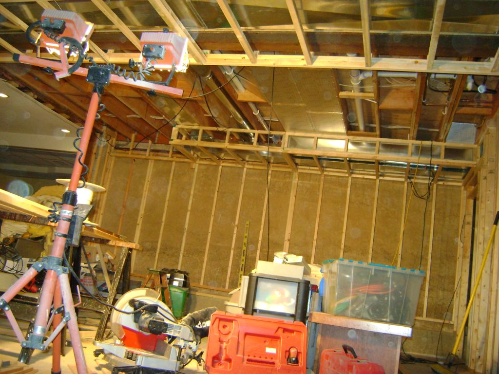

I'm in these stages now and need to read up on soundproofing. What the heck DO you do with the duct work???
I was thinking of spraying rubberized undercoating over the whole thing...now we already built a wood structure around it.
Any soundproofing advice you guys have I'd love to hear about it.
My HT is in the basement but the master bed is right above it!

Posted: Mon Dec 13, 2010 5:56 am    Post subject:
I think the only way to really avoid sound transmission through the ductwork is to isolate the HT. Give it its own HVAC so its ductwork doesn't connect to the rest of the house.
Unfortunately most of us can't do that, so I don't know that there's much you can do about sound transmission through the ducts.
Low bass is the biggest problem, and that conducts right through walls. (Or ceiling/floor in your case.) Isolation and mass are the way you stop bass. Ideally you'd isolate the HT -- box-inside-box construction -- so the HT walls don't touch the rest of the house and so don't conduct the sound. Again, most of us can't do that. You can use things like sheetrock isolation clips and Green Glue to deaden the connection between sheetrock and joist so less bass gets conducted through.
Mass is the other thing. Not much bass goes through the foundation because the mass absorbs it, just like eggshell foam absorbs high frequencies. You can put more mass between the HT and the house by double-sheetrocking. (And Green Glue between the layers of rock.) It won't completely solve the problem but it helps.
It also helps to pack the rafters with insulation. That's going to have more effect on midranges than on really low stuff, but it helps the bass too.
