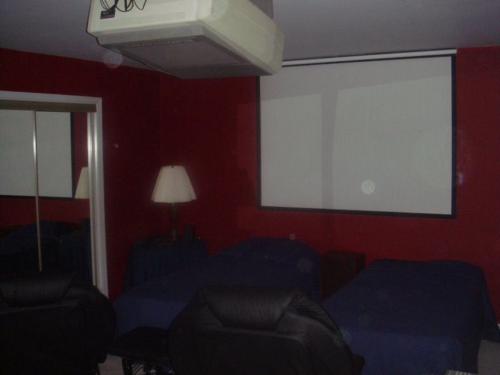

Posted: Sun Apr 12, 2009 12:49 am    Post subject:
I have posted some photos of my guest bedroom/theater room in the thread on white ceilings - you may want to visit that anyway for some potential solutions to having a white ceiling (As I indicated there I will be putting removable acoustic panels on the ceiling in the space between pj and screen to eliminate some light I get reflected off screen at that location).
My wife likes the dark red finish of the room (but it did take a lot of coats to cover - we did four coats); and to enhance its performance for CRT purposes the trim and ceiling were painted with Behr Silverscreen - which is a light gray paint; much better than white but still no where near as dark as desired for a theater. I have no problems whatsoever with the dark red paint. For daytime viewing; which is occasional and sometimes for things like my sons playing PS3 games; the venetian blinds and the dark blue curtains on the two windows do an adequate job of darkening the room.
My room is somewhat larger (17x13 ft) than the space you indicate (I guestimate 3 meters around 12 feet long). As you can see from photos my pj is about 11 feet from screen - allowing a full 100 inch 4/3 raster which is good on occasion but with geometry takes the top of the screen up to the ceiling. You really need this to avoid having the projected image too close to the beds vertically; plus it was right for the Marquee anyway. When vertically screened for 16:9 the image is sufficiently away from the ceiling but I do recommend masking in any event.
Some mistakes I would avoid and plan to fix soon - a major one was having the A/V equipment on a stand in the room; I should have place it inside the closet. That will require rerunning a lot of wires but what I have just is not appropriate for a nice looking theater room. I would probably set the subwoofer in the center between the two twin beds and allow that to support the center speaker. You may have a problem locating a center speaker with a single bed - I know I could not use headboard at the head of the beds.
I can fit quite a few people into the room for special events; but if my wife were more amenable I would prefer to have a couple rows of real theater seats instead of the low end ones we put in there. But that would make it far less friendly as a guest room.
Edit - I can't figure out how to post pictures - here's a link to the set of them:
http://picasaweb.google.com/Ralpharchi/Homehteater?feat=directlink#
Here is a photo of the room - there are others on my this web page that I linked to in the other thread.
Guest Bedroom theater
