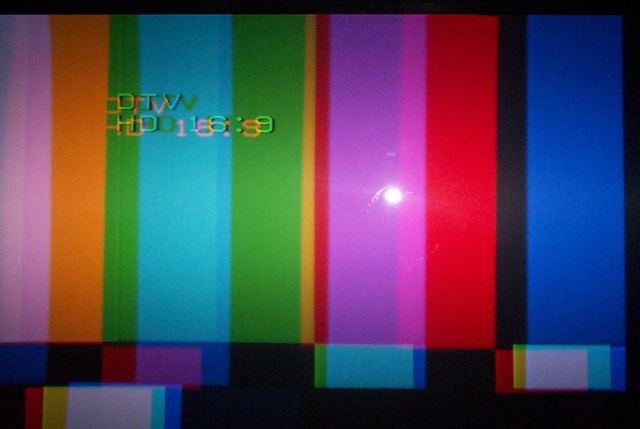

Posted: Sun Apr 12, 2009 6:04 am    Post subject:
Kevin recieved the Extron, he can get a picture at 1080i now from the HDFury1. However since he did the reset this is what he get's:

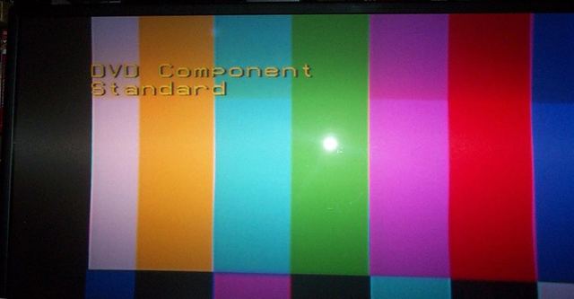

Posted: Sun Apr 12, 2009 6:08 am    Post subject:
He didn't reset his 480 though that's still working.
 Filesize:  18.71 KB

When I set the cable box to 480I, and the TV to DTV I get
It says component even though it is DTV because the Mitsubishi auto detects that it is in 4:3, and allows zoom mode if you are not in 16x9. The hour glass shape you see is real, not parallax from the camera. I used the sekret code to reset the factory settings and blew out my convergence on the TV. This tv has "crept" so that I am missing a good two inches top and bottom, side to side. I can not watch subtitled movies because the subtitles are cut in half.
When I set the cable box to 1080I I get
The alignment you see is what it looks like when I did the factory reset. It took about an hour to re-converge it. The convergence does not have an HD setting and a non HD setting. How can I set up the convergence for the DTV so that the TV will still works with the SVideo? This is important since the HDFury does not work with the DVD or the Xbox.

1: That does not look like a convergence ic problem.
2: The convergence must be done for different resolutions. I'm not sure what I'm seeing in that 1080i screen. I would rather see a test pattern. You can force set the DTV input to 480p or 1080i and then do the convergence. I'll type that up a little later.
3: I believe it will say component when only 480i is being sent. Pretty sure thats normal. As far as the zoom mode, you should be able to change that with the format button on the remote.
