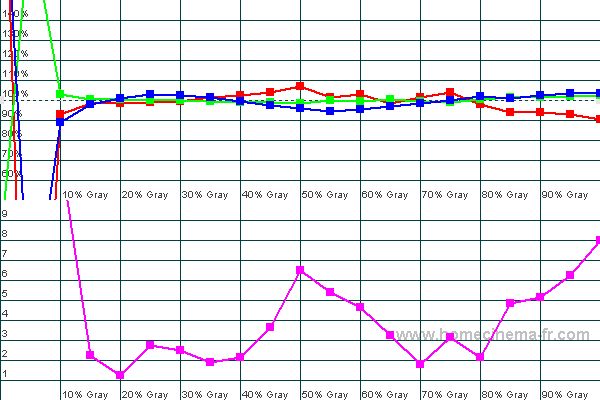

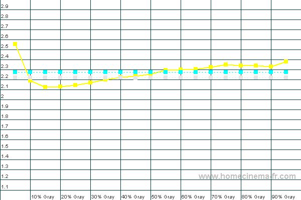

Posted: Fri Apr 03, 2009 5:07 pm    Post subject:
I just checked, and my blue is set to 30 (0 to 100 scale, with 55 being perfect focus) right now. Here are the grayscale and gamma graphs from about 6 weeks ago. I've done a little tweaking since then, but I don't have any graphs saved since these.
