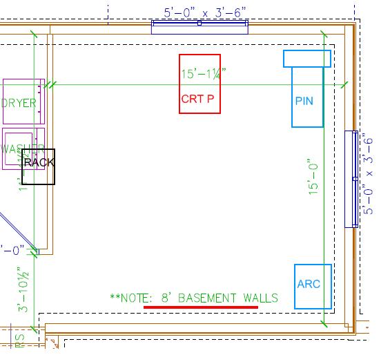

Kinda new to the CRT projector scene so I need some help making head way in planning for my basement install. Not looking to get this into the construction thread but just need help to get measurements so i can get over to the home theater thread.
Ok so I have a Sony 1252q on my hands that does work so i need to find what would be the best throw distance to screen size that I can work in the space that i have. Here is a shot of the building diagram of our basement with some rough details put in.
The basement is half type basement that goes 4 feet town and creates a ledge that is noted by the black dotted line. I am planning on building a soffit to add rope lighting and hide a electric screen that will drop down in front of the ledge that is formed by the wall. The ceiling is 8 feet high and i plan to drop the soffit 10 inches from and 1 foot around from the wall. So the height of the screen will be no more than 7'2" and the distance from the front of the Sony to the screen would be some where around 11 to 12 feet give or take my rough measurements.
Ok all that being all said, any ideas on how big of a screen can I safely order to fill the screen with the throw of the projector and how high do I need to build the table/lift/ shelf off the ground to set the projector on to hit the top of the screen? Any ideas?
Thanks for any help you can give.

The screen size and throw are a fixed relationship, so in essence, the projector can really only go one place for a give screen size (or there is really on one screen size for a given throw).
Since you really shouldn't go over about 8' wide with a 12xx, and throw is approximately 1.2x screen widths, that means your max throw can only be around 10' or so. If you go to 11 or 12 feet as you mentioned, then you'll end up with a screen size of around 9-10 feet wide, which is going to give you a picture on the dim side, and you'll have to crank contrast to compensate, which will decrease sharpness.
The easiest thing to do is to use the "cart" method: Setup the projector with a source and maximize the raster, put the projector on cart or furniture dolly, and move it around until you find the right spot.
If you have a Windows computer, you can use PJCalc to find the right spot... However the software is conservative with the throw and in reality you'll be able to move the projector 5-10% closer than recommended. It will help give you your offset, too (throw angle).

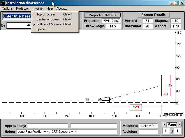

Select "Bottom of Screen" from the "Position" menu.
Yes, the software is definitely clunky - it's over 15 years old, now!
I'm attaching PJcalc 1.8. It has the 12xx models in it, so you can go to town.
