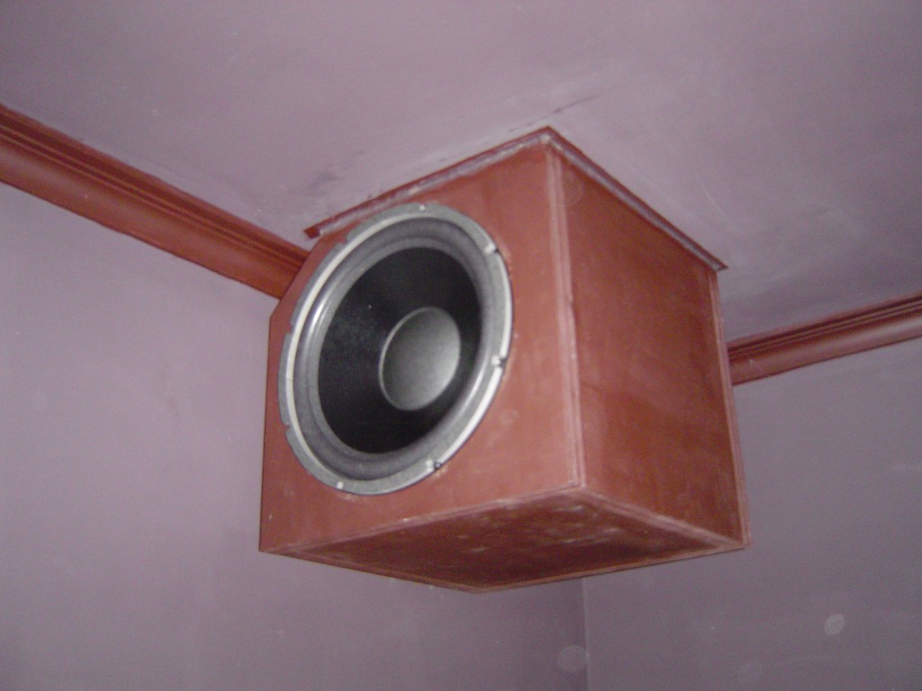

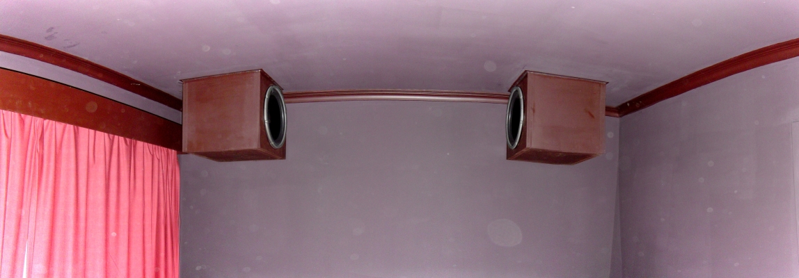

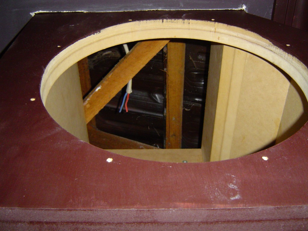

The best is an Infinite Baffle sub - a sealed box so big it is in effect, infinite. Two to four 15" woofers (cheap ones will do) and a roof cavity/spare room/floorspace/basement.
With a suitable driver, you get both deep extension (mine will literally shake the roof, projector and all, at 14hz), output (huge cone area), and good phase response (due to flat response - they are entwined) - giving you "tight" bass. And use bugger all power (huge cone area again).
With conventional boxes, well, you can make a ported box with and effective "Q" of about 0.6 giving you a "sealed box sound". It's not so simple as sealed = "tight" and vented = "boomy". That all depends on the frequency response, and associated group delay, and associated phase response - they are all basically sides of the same thing.
But as a rule of thumb, NEVER, EVER, NEVER make an EBS alignment ported box (tuned for maximum extension). They sound like crap and this is why ported boxes are regarded as "one notey". The EBS alignment is "one-notey", but not all vented alignments are.
Oh, and there is no spoon...nor fast bass. Fast bass is treble, if anyone mentions fast bass they deserve a smack in the back of the head Rolling Eyes I'm glad no one has dropped that clanger in this thread so far.
