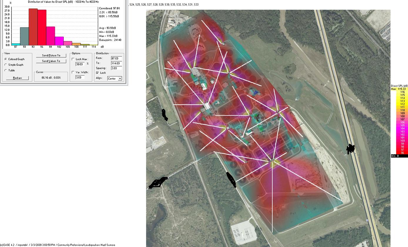

I am putting together a bid for a emergency voice notification system for a large outdoor area. I am going to have a total of (30) of the Community RSH-462 speakers (attached data sheet) mounted on 9 different buildings. There will be anywhere from 9 to 1 speaker(s) on each bulding. Each speaker requires between 630w to 900w @ 8 ohms. I would like to have a seperate volume control for each speaker. Any recommendations for amplifiers?

We are having to cover an outdoor area approx 5000' x 1800'. The building with all of the speakers just happens to be located in a good location. Community speakers was great to work with. Attached is a mockup that they did for me.
