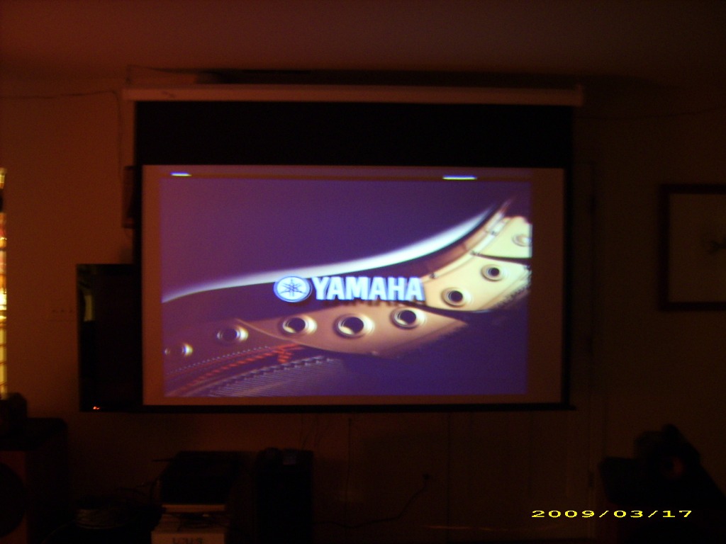

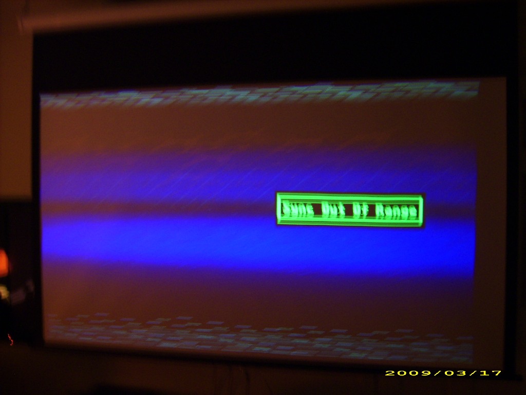

I thnik there is something wrong with this moome V1.2 card. Just hooked up a brand new Toshiba Yamaha S1800 player and it's doing the same thing. On the component the DVd menu's are fine but as soon as you put in a movie it shows "synch out of range". Can someone please chime in, has anyone had this problem before? (PICS)
BTW, the HDMI side of the card worked fine when I tested it, never tried component.
 Filesize:  105.61 KB
 Viewed:  7780 Time(s)
 Filesize:  106.15 KB

what mode does panasonic and Yamaha output to the component? is it 480I?
the card will only support 480P 1080I 720P and 1080P~

thank you moome for replying. I think the panasonic RV-32 from 2002 vintage might have been a 480i DVD player. However the new Yamaha S1800 shows these resolutions only
# Upscaling Yes
# Output Resolution 480p , 576p , 720p , 1080i , 1080p
However I also found this
Component Video Output: The DVD-S1800 features a component video output, capable of passing a progressive scan signal or an interlaced video signal. If the component output is to be used, the HDMI output must be turned off.
so it looks like the S1800 might be outputting 480i through component. Luckilly the DVD menus are working, I will have him check this

hi:
please use 720P or 1080I for best performance on component card

Hi Moome, I think the component side of this card is bad. This is what my friend found
"With HDMI cable and Yamaha S1800 it does work.
Funny enough, now with another DVD player [California Audio Labs CL2500], when I use component and certain dvds [ from both EU and US] it shows a picture with colours off but no sync error message, while with the same player and other dvds it gives sync error...
There is definitely something wrong with the Moome card: when I have the HDMI cable in,it does not matter which position the switch of the moome card is, the picture stays the same; with component in, if I switch it to the side of HDMI the image disappear...?
The colors being off with component sounds like an old issue with the external boxes. I've never read of this with internal cards though. Is this repairable?
I have worked with about 10 different cards now for many years and never seen a single problem ever, this is unusual.

Posted: Mon Mar 23, 2009 10:02 am    Post subject:
SURE,I can repair it.
email to me and i will tell you the return address
