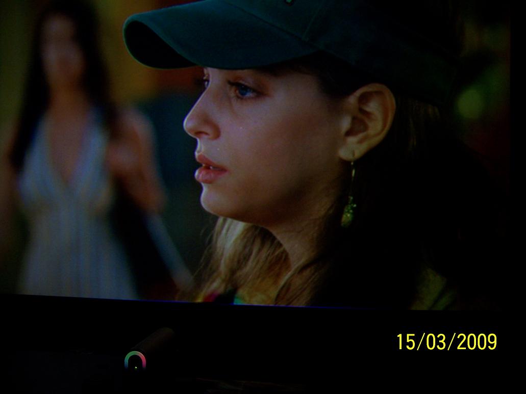

I added a quick screenpic from dvd to show that the picture ain't bad at all! I had to set brightness above 60 and as mentioned contrast just couldn't go high enough.

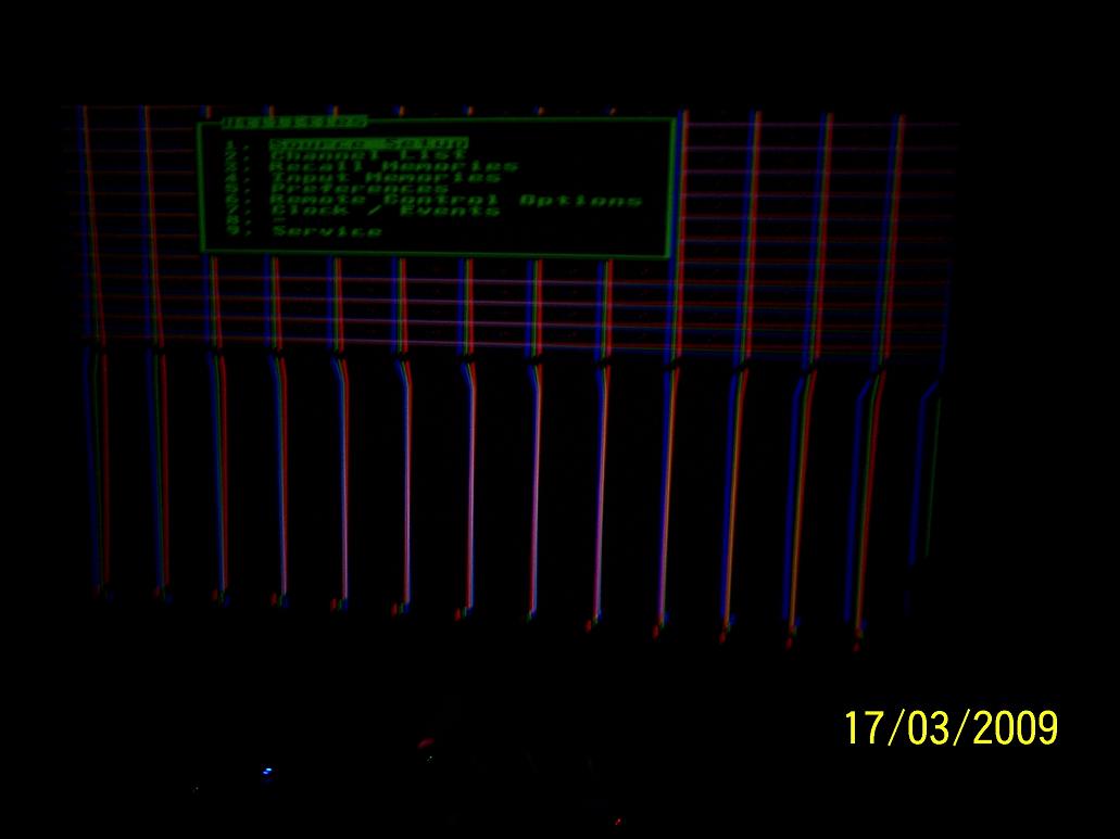

Hello, I replaced the HVPS and after 10 seconds of nice functioning the horizontal sync suddenly shifted very much of. I think I heared a relais switch and then the white testimage shifted vertical leaving a black area in the middle.
Eventhoug I checked how the colors responded with contrast and it seemed much brighter. So that is the positive side, the HVPS fixes the problem with the lumens it seems.
Now what could have happened? I checked all the wires ten times, nothing wrong. I can even watch dvd but it is all shifted vertical.
I added a picture. Someone knows more?

Posted: Wed Mar 18, 2009 12:24 am    Post subject:
Try using the vertical phase adjustment? I have not seen that bad of a fold over before. I have gotten it on just the edge of the bottom or side, but never that bad. Anyone else on this?
Posted: Sat Mar 21, 2009 12:45 am    Post subject:
Hello
Looks to me like the vertical distortion is the control board or deflection processor. Try a Nashou-style cleaning and reseating of the control board and dpb socketed chips and interconnecting pins.

Posted: Sat Mar 21, 2009 1:00 am    Post subject:
That was one of the things my current Marquee did while I was having issues with it. Yes, a cleaning certainly seemed to take care of it, for the time being...
