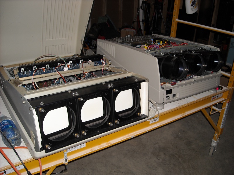

I'd planned to use the better of the 3600's for the time being - the old Barco 701 can't do 1080i for crap. Per the seller, the sets all worked. Haven't been able to fire up the Ampro's yet though without the remotes. Both appear to be spotless internally, so that's a good sign...

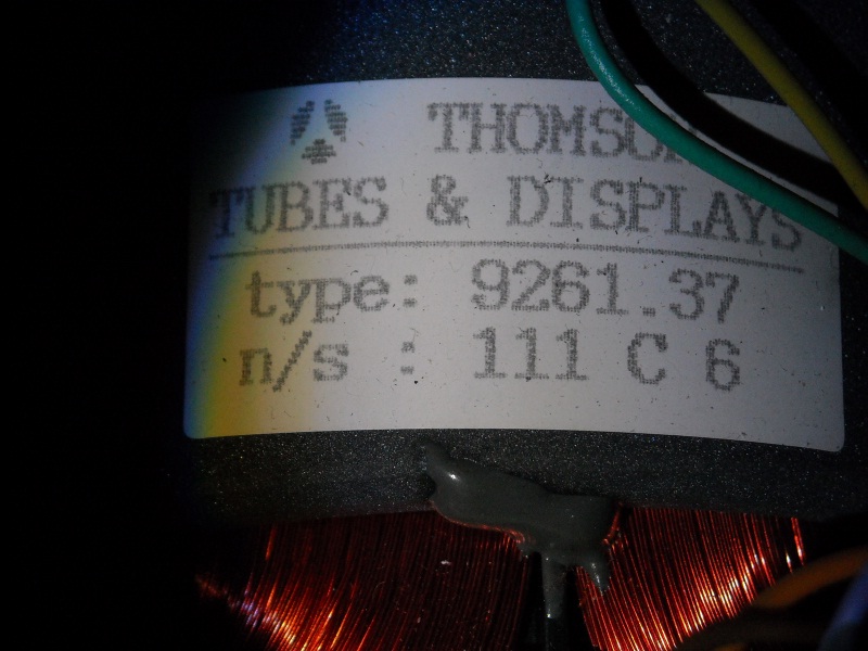

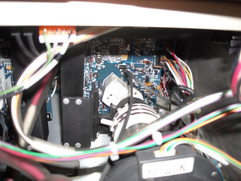

For what it's worth, I've attached a couple pics of the tube/neck board - maybe someone with a little more knowledge than I can tell me what's in it.
Better of the 3600's and the XG 135

Label on tube

Close up of neck board

You need the tube number off the bell of the tube, on a sticker. on the Ampros, you'd need to pull the tube to get to it under the metal shield around the front of the tube. Don't worry about it, fire it up and tweak.
