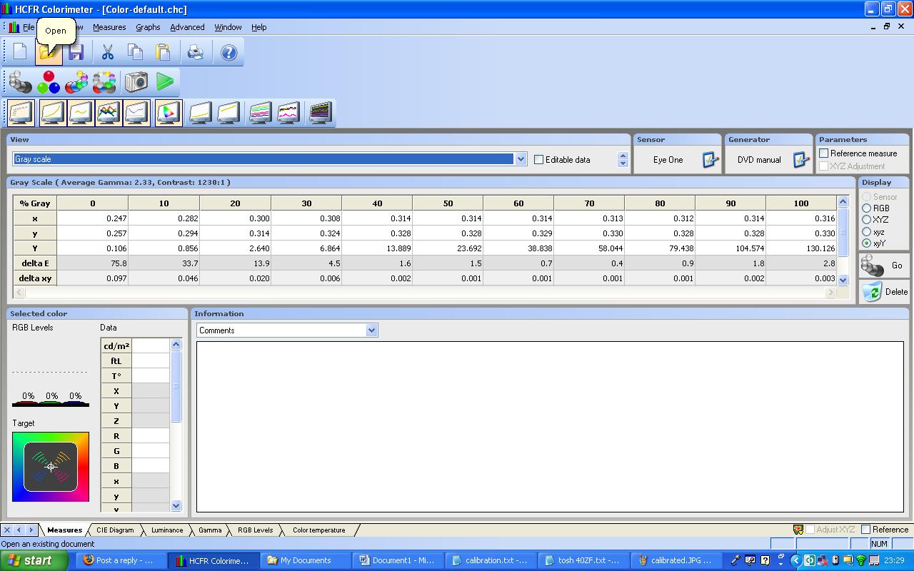

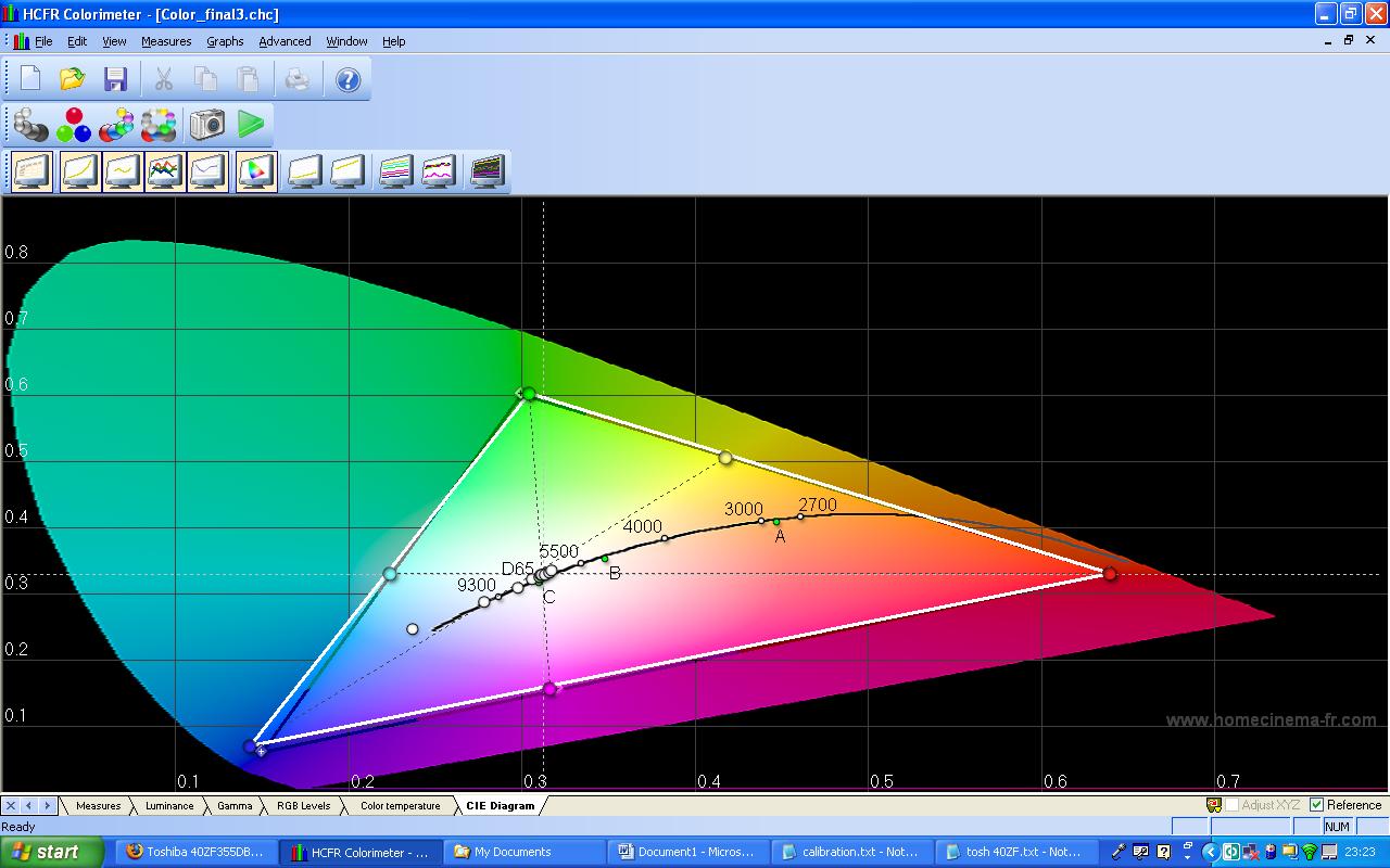

Attached is the CIE diagram for the calibrated display - as best as I can get after a couple of passes. While whatching Sky SD and HD the skin tones look a little washed out to me and on the orange side of things.
Thoughts and comments welcome.
Colour DeltaE
 Filesize:  142.16 KB
 Viewed:  1 Time(s)
Gray Scale - DeltaE
 Filesize:  148.55 KB
 Viewed:  2 Time(s)
CIE
 Filesize:  124.41 KB
 Viewed:  2 Time(s)
