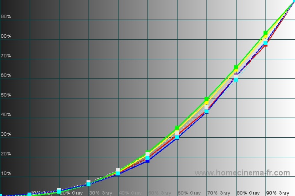

Posted: Mon Jan 05, 2009 7:17 pm    Post subject: Eye One versus Spyder two (HCFR)
Today had the chance to do a comparison.
Images: first EyeOne (E1), second Spyder2 (S2)

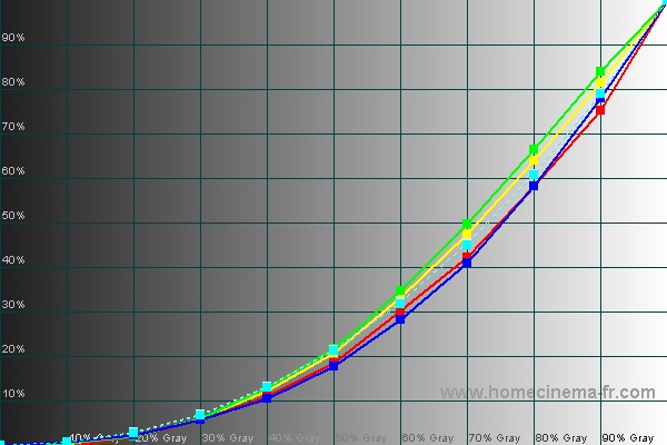

LUM

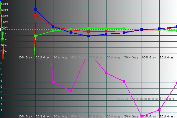

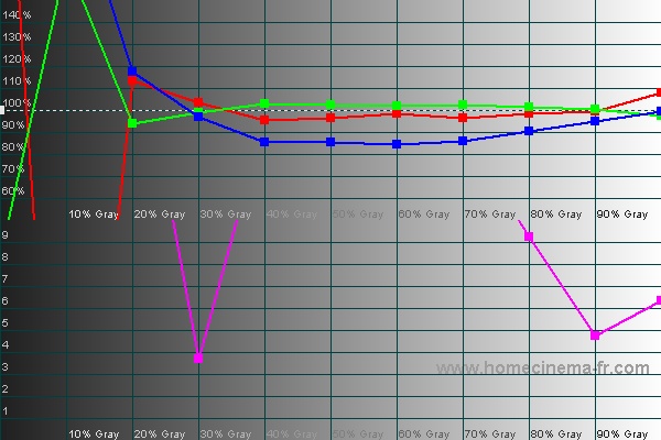

Posted: Mon Jan 05, 2009 7:21 pm    Post subject:
Yeah I know the actual calibration is still off....waiting for my Lumagen HDP Wink

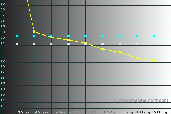

Posted: Mon Jan 05, 2009 7:22 pm    Post subject:

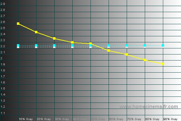

Gamma

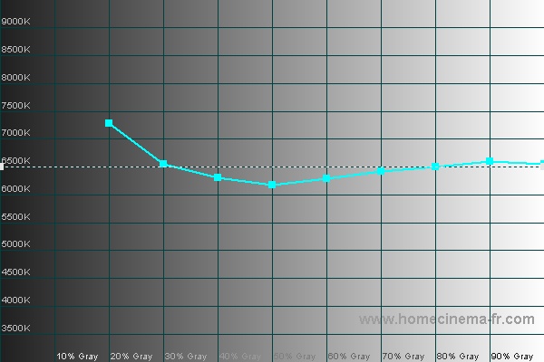

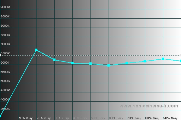

Posted: Mon Jan 05, 2009 7:23 pm    Post subject:
Color Temp (for what it's worth)

The EyeOne seems to be the better in the low levels (as expected)...and Spyder2 is making a mistake for blue (as known)
