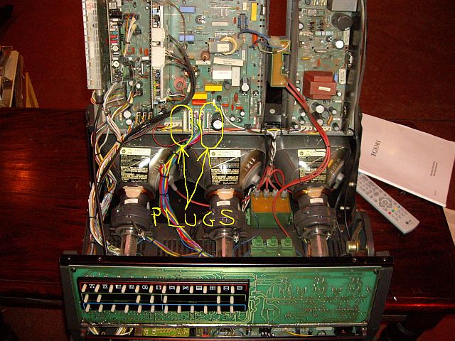

i just aquired a TSG 100 but dont have a user manual the picture is set for front ceiling and would like to front floor mount I have opened it up and found a couple of plus with plastic wafers attached are these the scan reversal/invert plugs and how do the locate ? look forward to you comments

You've got the right area..Smile
I think there's a 'dummy' jumper that moves from one location to the next, I think it's the circled jumper on the right that moves to the left, but it's been so long since I've worked on one of those, I can't remember. Give it a try, and pull the green and blue tube CRT sockets before you power up. Leave only the red connected, you're least likely to damage the red phos[hor if you have a scan failure. Be ready to pull the plug if you see a line or dot appear on the red tube.
If you get full raster/image on the red tube, push the G and B sockets back on, and you're good to go.
