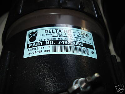

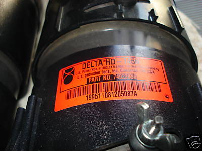

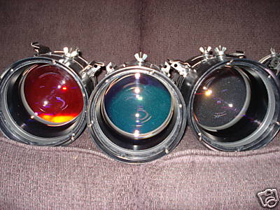

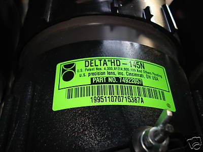

Thanks Hailtoby and Analog! I really appreciate your help. To be honest I haven't really open the machine yet to see what I currently have for lenses on the 6PG. I will be doing this on the weekend. Ill post something on that once I take a look. Hailtoby - I am currently in talks with a guy regarding some lenses on e-bay Im alway a little leary about e-bay stuff but Im looking at a good deal. These were appearently out of a NEC PG Xtra see the pics attached. If this falls through I will contact you regarding your lenses.
If anyone has any advice on wether these would be the right it would be greatly appreciated.
Mike

Posted: Fri Dec 12, 2008 9:50 pm    Post subject:
Yep, those are the ones. They should bolt on with absolutely no problems and they will be a nice upgrade from the, Im assuming, HD6 lenses.

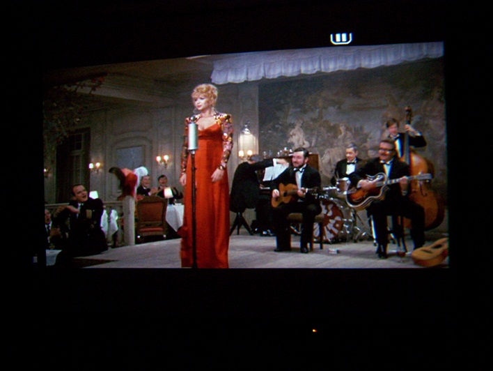

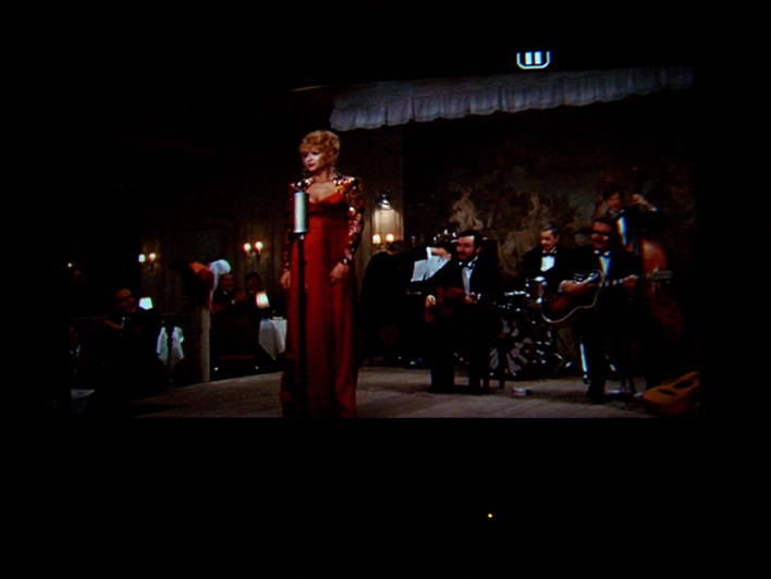

Hi Mike - I snapped two quick pics of my quickly-setup 7"ESF machine for a GammaX comparison for you. There are some sales pics and others around, but thought this might help. My setup is:
OPPO DVD upconverted to 1080i -> HDMI -> HDFury3 -> GammaX -> 50ft RGBHV cable.
One is GammaX set down all the way (as if not there) and the other is with it set about 1/2-way up. This shows you what it will do. For now, it helps this noob tolerate dark movies like Black Dahlia and Das Boot.
If you buy the tinted 145s, I'd be a little interested in your tinted HD6Cs (for not very much, though!).
Matt

Posted: Sun Mar 27, 2011 8:58 am    Post subject:
They are not hard to set up either, you just need to know what setting does what. When you know that, and which one to adjust, they are very easy to set up.
Ill almost bet you have that HD Fury set to the 0-255 colour space, if you set it to the 16-235 colour space, youll find itll be brighter in the low end.
See how her face looks un-naturally white? Try it with the HD Fury set on the 16-235 mode, and with the GammaX removed, and itll look somewhere in between what you have posted, or it certainly does in my experience with a 9PG.
Posted: Sun Mar 27, 2011 9:10 am    Post subject:
Also in my experience with the HD Fury 3 and the GammaX, all the way down on the GammaX is NOT the same as gone completely.
Im certainly not saying dont use the GammaX, im saying try with the HD Fury 3 with DIP switch 4 turned OFF so you dont have the HD Fury 3 trying to upscale the colour space, and then try with and without the GammaX.
Om not saying im a foremost expert and know everything, im just saying try it, and if you see what i saw, youll be happier with it on 16-235 and you may even find you dont need the GammaX in the chain for anything coming out of the HD Fury 3.
