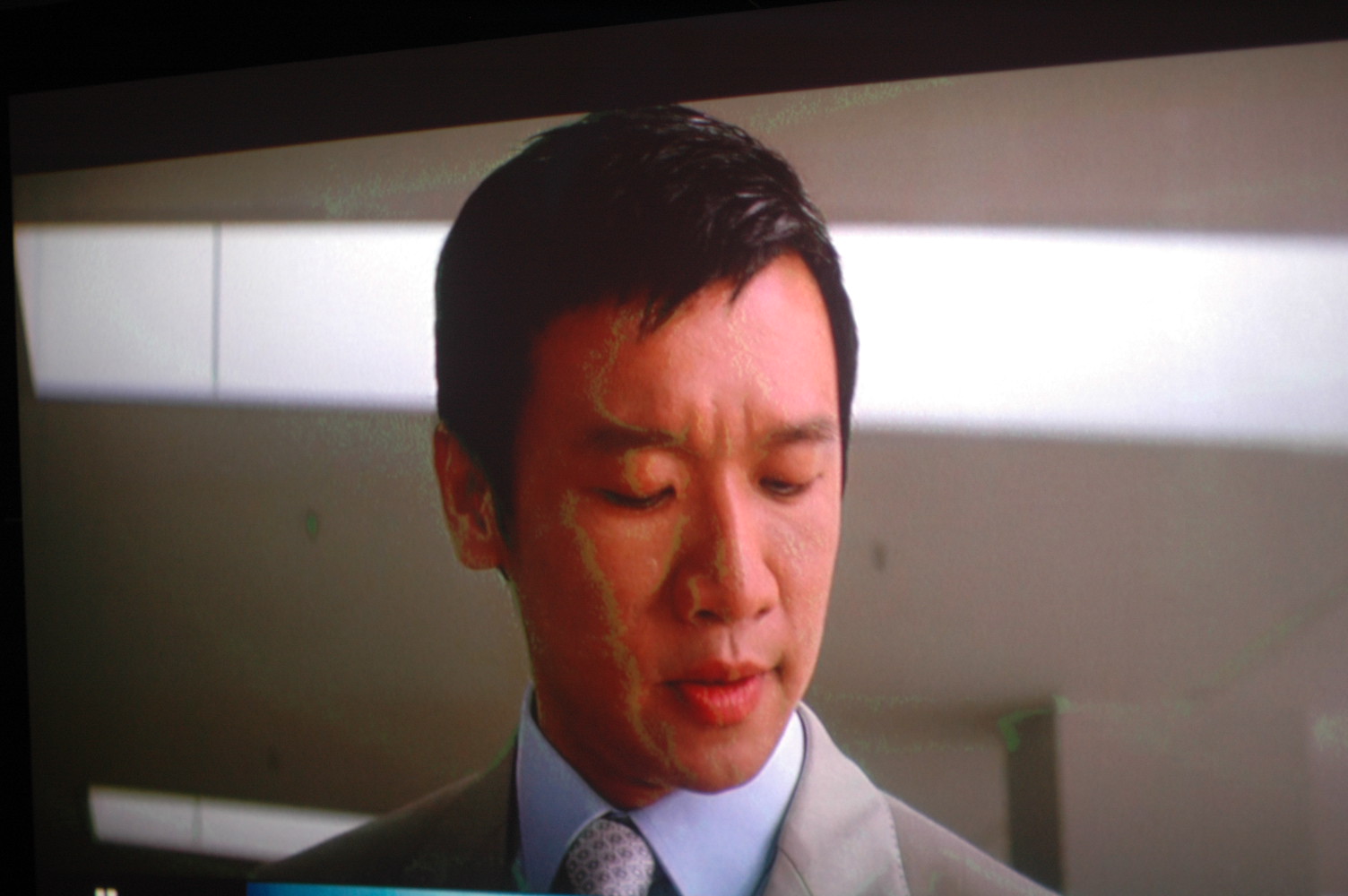

Need some advice - I just started to notice light green colour banding (faces - walls etc..) when I say "just" it wasn't there a month ago when I last used it. The PJ is driven by a PS3 set to 1080i. Also I've never been able to set the gamma. The yellow light will only blink, I can see no obvious correction taking place.

Post a close-up picture of this green banding as I might have an answer for you. Which Moome unit are you using and when did you buy it?

I'll have a go later with the cam & tripod. It's the IFB-HD card i.e. single HDMI. The green banding is 1-2 inches across

Posted: Tue Dec 09, 2008 5:42 pm    Post subject:
Here you go.....
 Filesize:  210.55 KB
 Viewed:  7642 Time(s)
Cheers Chris

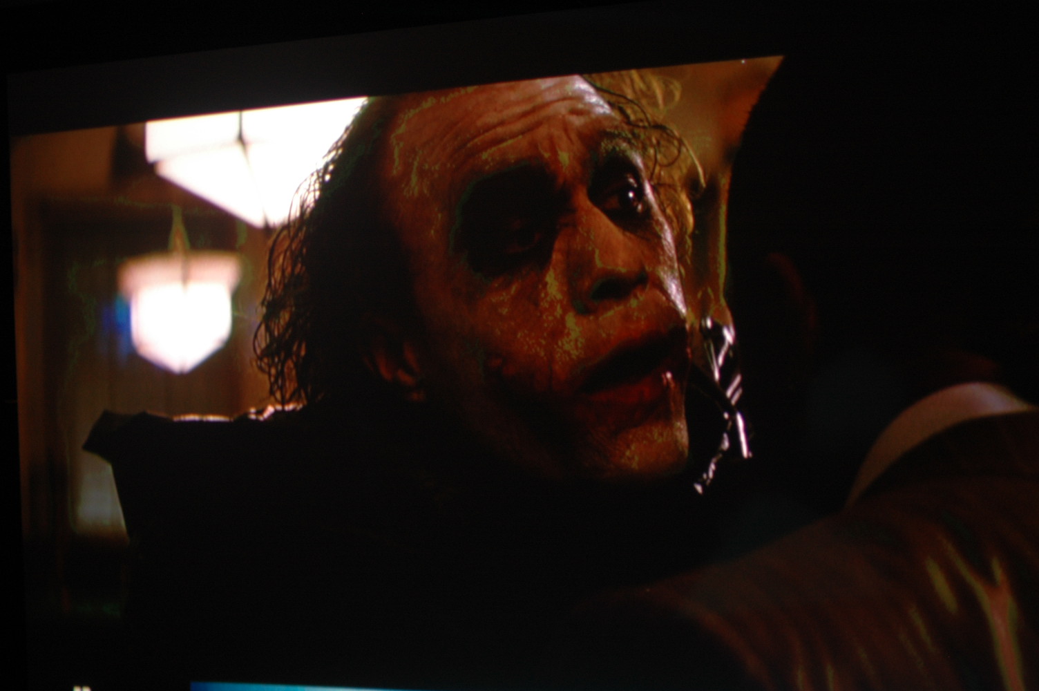

Posted: Tue Dec 09, 2008 5:45 pm    Post subject:
another
 Filesize:  212.76 KB
 Viewed:  7636 Time(s)
Cheers Chris

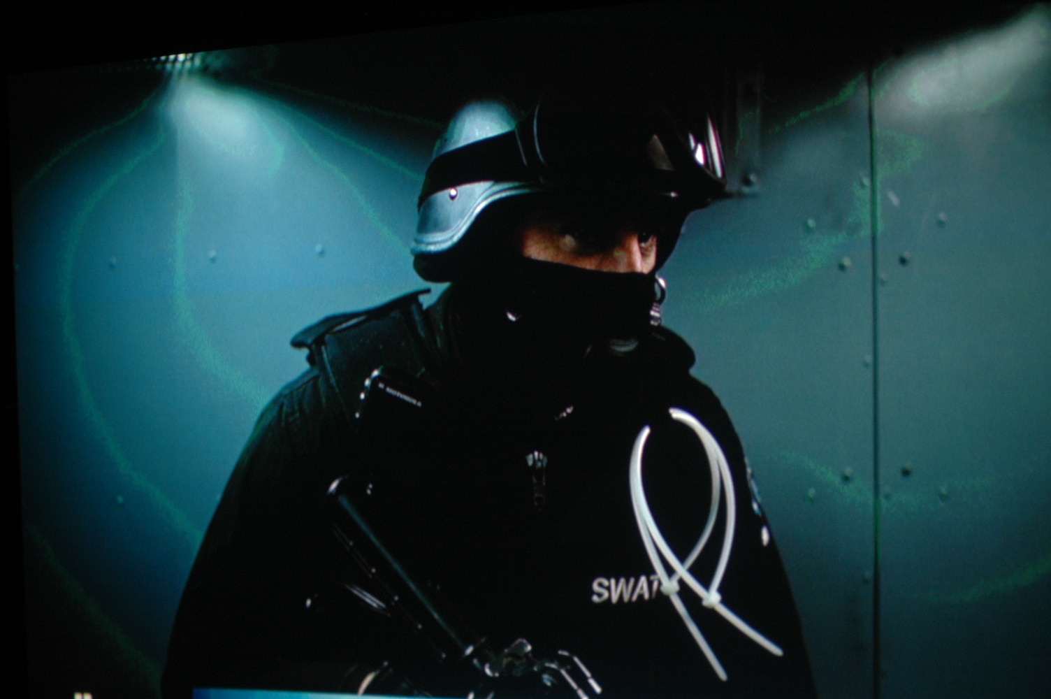

Posted: Tue Dec 09, 2008 5:46 pm    Post subject:
another
 Filesize:  220.27 KB
 Viewed:  7639 Time(s)
Cheers Chris
Posted: Tue Dec 09, 2008 5:47 pm    Post subject:
Oh man, that's hideous. Looks like a digital projector malfunctioning! Looks like a Moome problem to me.

Posted: Tue Dec 09, 2008 11:58 pm    Post subject:
Yes that is a problem with the Moome unit, send an email to him along with a couple of those pictures and he'll take care of it I'm sure. I know what the problem is with the unit but I'll let Moome discuss it if he is willing to.

Posted: Wed Dec 10, 2008 8:58 am    Post subject:
Thanks Fellas I appreciate the help - I've got moome on PM. Will let you know how it goes.

Posted: Thu Dec 11, 2008 11:05 am    Post subject:
Moome will repair the card for free, just need to ship over to him.
The timing is bad with Xmas and all but it is what it is!
Thanks for the support fellas

Posted: Thu Dec 11, 2008 2:33 pm    Post subject:
Wow, what a strange looking effect. That's not at all what I was expecting to see from the way you described it. I hope you get it worked out quickly.
