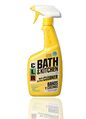

Posted: Tue Nov 25, 2008 11:43 pm    Post subject: I guess ammonia it is then
CLR what is this anyway, I read somewhere it was a bathroom cleaner?
 Filesize:  56.94 KB
 Viewed:  7252 Time(s)
The more I learn
the less I know.
incova
Joined: 27 Nov 2006
Posts: 789
Location: london
Posted: Tue Nov 25, 2008 11:46 pm    Post subject: this it?
Not sure we have this in the Uk I think I better stick to the ammonia if thats ok, also the fungus is on the C element should I just wash it of with distilled water or can I use normal hot water?
