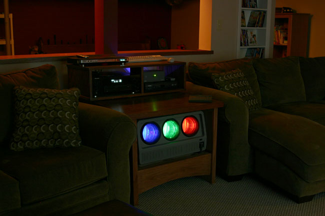

Why won't you be able to hang it from the ceiling? Floor mounting is an acceptable solution, but most people around here (including me) will tell you you'll be giving the projector the best seat in the house. OTOH, I have a good friend with a 1252 in what we typically refer to as a "coffee table" mount. He has a sofa flanking in on each side and it works very nicely.

Take a look at my buddy's room in page 2 of this AVS thread on floor/table mounts. It was a 1252 in the pics and was later upgraded to a 1272.
http://www.avsforum.com/avs-vb/showthread.php?t=1003849

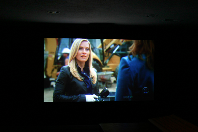

85.33x48 painted drywall screen. Very low-budget, but great room.

you mean this?
Nashou Very Happy
