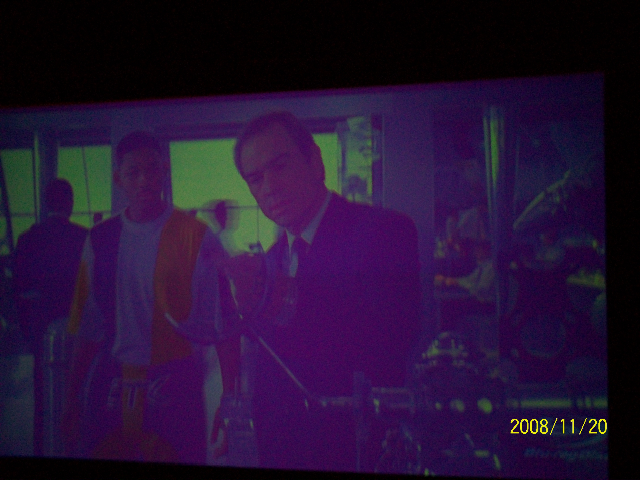

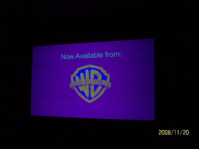

Hi guys, I used to have my Samsung BDP-1400 hooked up to the HD Fury to the Barco 1208s. However, yesterday I swapped it with a new PS3, however after that the black levels are really bad and everything seems to have a pink touch (extra red and blue). I'm not sure how to fix this, when I change the color balance in the picture tuning, it helps a little but not nearly enough to make it look nice, here are some pictures of how it looks (sorry for the bad quality though).
Please let me know what you think.

It looks like the PS3 is set to output YCbCr (component) on the DVI. Go into the PS3 Menu and switch it to RGB.
