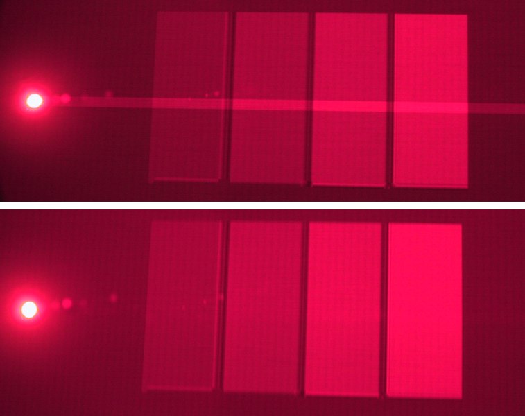

My streaking test picture. Brightness need to be adjusted so that all four rectangles are shown.
http://www.curtpalme.com/forum/download.php?id=1342
Upper tube shot with stock 75 MHz rgb amps.
Lower tube shot with abl removed.
 Filesize:  43.31 KB
 Viewed:  16122 Time(s)

Yes, removing abl jumpers doesn't make any difference. Video signal still goes through abl components and system is still active. I believe abl have been designed using crappy components (IC4 etc.) and it causes streaking problem and lower BW. I removed pretty much all abl related components.
