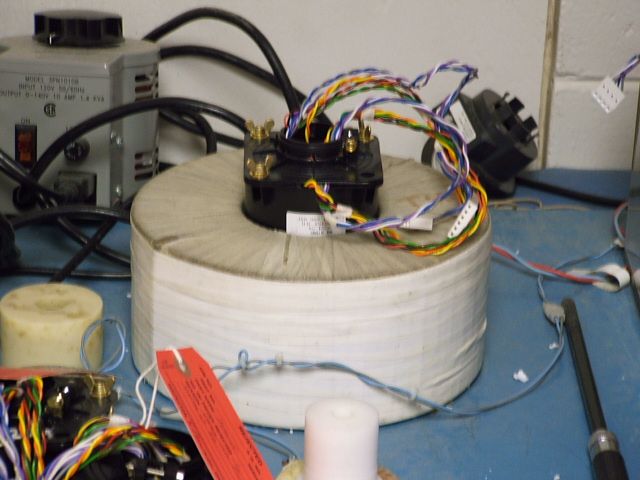

"Hey Scott is possible to make one of those? it looks like a transformer coil powered by a variable transformer?
Crt's rule! I love this new Obsession!
Marquee Stuff"
I started a new thread with this.
If you can get a torroid transformer/coil big enough it wouldn't be too hard to do. A variac connected to the coil will produce an AC magnetic field which will lower the gauss. To increase gauss one must produce a high current DC pulse through the coil. It is easy enough to charge some large caps (a few 1000uF) to 200-300V and discharge through the coil. A gauss probe is very helpful when doing this.
Scott

Ok I see so you would need a DC variable power supply to get up to 200-300 VDC or could it be a fixed rate one?
Then you would put a few high voltage and high uf caps in series or parallel ?
These would be charged up and then released in pulses through the coil?
How long and how do you create the pulses, and for what duration should the focus magnet be in the coil for?
And finally how are the caps connected to, i guess, the pulse generator and then to the coil?
Very Happy
Posted: Fri Nov 14, 2008 1:18 am    Post subject:
THat picture is truly of the bench of a mad scientist! Very Happy

This is Bumped for Chris Johnson to see, he wants to build a gauss rig for the marquee magnets.
Posted: Thu Feb 04, 2010 3:47 am    Post subject:
I've seen that rig before. At VDC. Scott showed it to me. He adjusted a few coils and I observed the process.
I'm building my own version of this. It's a bit smaller but will take a K-D focus magnet system with the shell removed. It's too small for
a Thomson yoke, unfortunately.
I also have obtained some of the specs for the pictured magnetizing rig so I know what inductance values to shoot for.

I was going to make one of these too to bring up the gauss to the same as the barco 1208 coils which are the same stregnth as the stock Marquee's. the Sony 1292 coils are not as strong I found from my testing. I have one wound to marquee specs but I want to try a slightly thicker wire for the dynamic coils where it matters more to have less resistance which will allow the Dynamic focus amps to run cooler.

I think you'd need a gauss meter , then test some thompson coils on the tube and find the one with the best static focus, measure that and set up the rig to increase the gauss just till you get perfect focus with no electronics.
