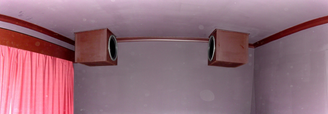

Did someone say insane subwoofers??
FOUR, yes FOUR 15" woofers mounted to my ceiling Twisted Evil

Mark, do you realize how much power you are wasting with four 15" subs mounted on the ceiling. Couldn't you get by with only one, seems like a terrible waste of energy. Mr. Green
Mike
Posted: Mon Nov 10, 2008 4:04 pm    Post subject:
Good one, Mike! Laughing
Posted: Mon Nov 10, 2008 4:10 pm    Post subject:
I knew the other side of the world was upside down! Very Happy
Posted: Mon Nov 10, 2008 4:34 pm    Post subject:
whats6x7 wrote:
btw - Why ceiling mount? I mean, I guess sub placement isn;t really critical but I've never seen them on the ceiling. Cool.
That's an infinite baffle (IB) setup. It uses the entire space outside the room (in this case, Mark's attic) to contain the "backwave" from the drivers. It's highly efficient and can generate wicked SPLs. I've heard that once you hear one, you're hooked. Some people use attics, some use basements or crawl spaces, and some use different rooms.
In my case, IB just isn't practical, since my goal of sound isolation and the side effects of IB are somewhat at odds with one another. OK, I was being sarcastic - you can't have as a goal sound isolation and use an IB sub, since by definition, you're using another part of the house as part of the sub enclosure. If you went up in Mark's attic, there would be nearly as much bass as in his theater. IIRC, Mark's setup is in a completely different structure or isolated from the main house, somehow - which would be ideal for an IB setup.

Posted: Mon Nov 10, 2008 8:45 pm    Post subject:
Mike
Well, yes and no.
Yes, energy needed to make and ship the drivers.
But they are so efficient that they take only a few watts to shake the room, so over the long run, I use less energy Wink
