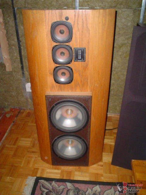

I have a pair of Infinity RS-II speakers. Each speaker has 2-10" woofers with foam surround. I tried a couple of times but was unsuccessful (a mess!!!!). After that mess, it was much easier to pay someone to do it.
wallace
(the pic below are not my speakers; mine are packed away.........)

YOU HIT THE NAIL ON THE HEAD!!!!! I tried the kit and could never get the voice coil shims in correctly (evenly).
And of course the glue and foam is a "hit or miss" type thing. Once you start setting the foam on the glued surface, thats it. There is no pulling it up and trying again.
Again, I salute those that can do this properly!
