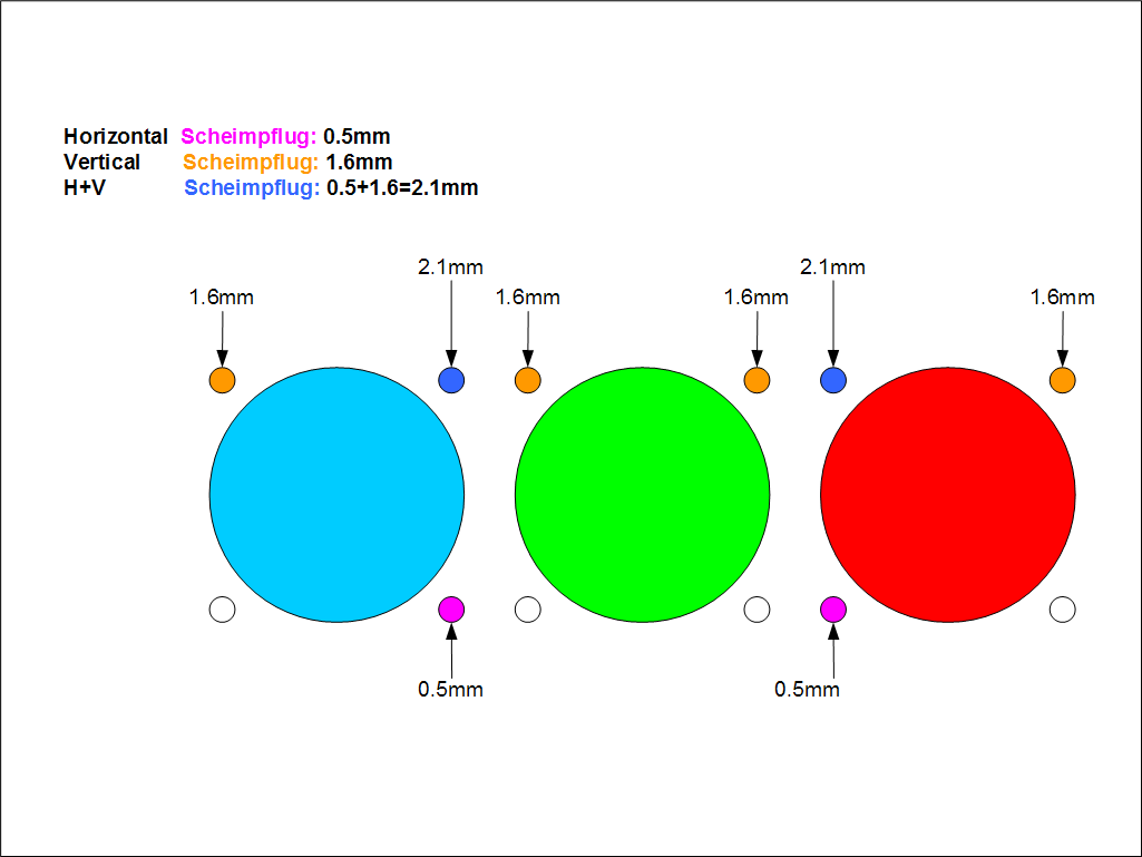

I am in a Front table configuration with the projector flat on a little table. I think the shims should be placed as shown on this diagram:
Questions:
Is my diagram correct?
Where do I put the shims: On the lens side or on the CRT side? (Lens side would be sooooo much easier Cool )
I rounded up the thicknesses to the nearest 0.1mm, Is that accurate enough? (I think it is, I'm just checking)
Do you think I will notice the difference between now and with the washers?
Damien

I can't see your link from my work computer (non-work-related Internet sites), but heres what I get.
Actually it doesn't matter which side you put shims, but lot easier on the lens side.
0.1 mm accuracy is good enough. Now you should get top/bottom/sides focused at same optical focus setting.

Thanks again for the nice drawing Ile. Your drawing and mine look like twins so I guess I'm good. I also couldn't look at your first drawing from work because of the firewall.
