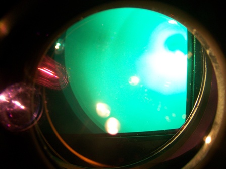

Some background: the MS07 tubes (so much for my "I have a Golden Ticket" 07MTS wishes) look to have never been run at all. I see no fungus or blemishes, either. And IF the flaky guy I bought it from is to be believed, the unit only ran for one year as a display model in the late 1990s and has sat ever since. On this later point, I'm actually inclined to believe him given the dust that covered it. Anyway, I'm guessing that means ~1500hrs MAX use. I have simply plugged the unit in and played for about 5 mins.

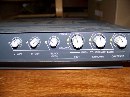

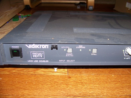

The unit came with a Vidikron LD40 control unit (Faroudja-made line doubler+?) that I can find ZERO info on. It has controls (see pics) and supposed will let me control the projector remotely (via RS232). Do I have to use the above control unit/doubler? When I ran my Laserdisc S-vid through the LD40 *without* connecting the serial controller and into the projector's RGBHV input, the images are uniformly too high on the raster area (the raster areas look about ok) and the image quality is poor. When I did the same thing using a DEC IDC 3000 I was given, I get total garbage onscreen.

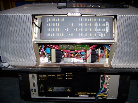

When the frilly Vidikron Pinafarina case is on the unit, there is a big ugly hole on the back and the wired (remote) controller can't be seen at all! So when I bought the unit (month ago) and saw the hole, I just figured the control has been scavenged and then bought one from a nice guy here two weeks ago off a ECP 4500. Imagine my surprise last night when I took the top of the case off and there was the controller -- and they even bothered to make it say Vidikron! How bizarre. So -- why the hole? And why "hide" or even include the wired remote at all?
the back of the VPF 50 HD with top off
vidikron LD40 left side
pic of 07MS tube taken with flashlight pointing in

vidikron unit is nothing but an ECP in a pretty box.

the LD40 is an earlier LD100 with fewer inputs and likely a bit less capability on some axes.
#4 - who knows...maybe note seen in 99% of installations...

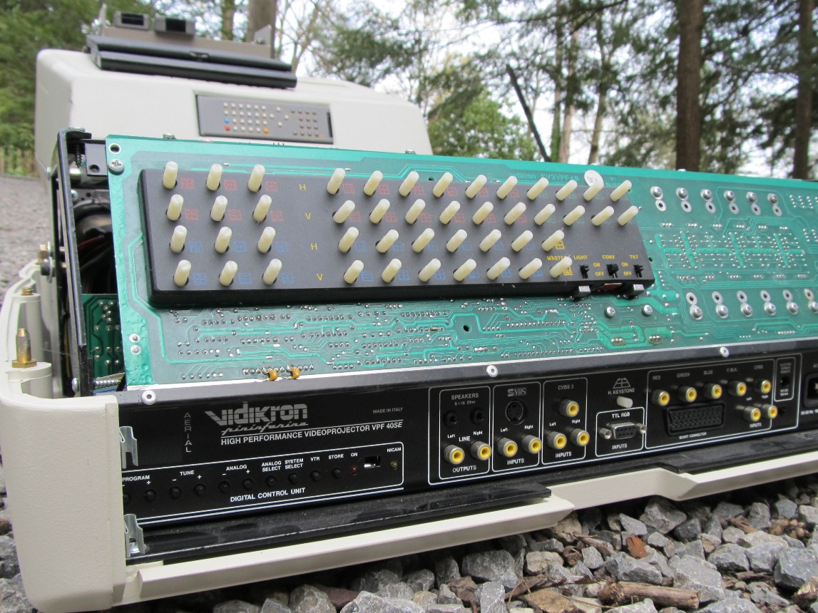

Another installment of Answering My Own ECP Questions From Over a Year Ago...
So turns out the Pininfarina case was made by Vidikron for their own machines way back in the SD analog convergence machines days. They simply figured out the cases could fit over the ECPs, cut holes in the bottom of the existing molds, and patched it onto the ECP chassis. See pic. I thought it interesting the PJ was made in Italy and Vidikron made all their own boards, etc.

vidikron-made unit the shell for which fits on the ECPs

Hole in the back of the case- you're most likely missing a long rectangular part of the case that covers that back area. The clips die, leaving that hole when the owner throws out the strip.
