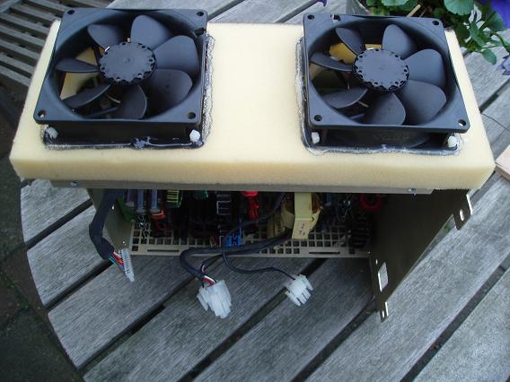

Implemented your lvps mod and it works great Thumbs Up
 Filesize:  53.29 KB
