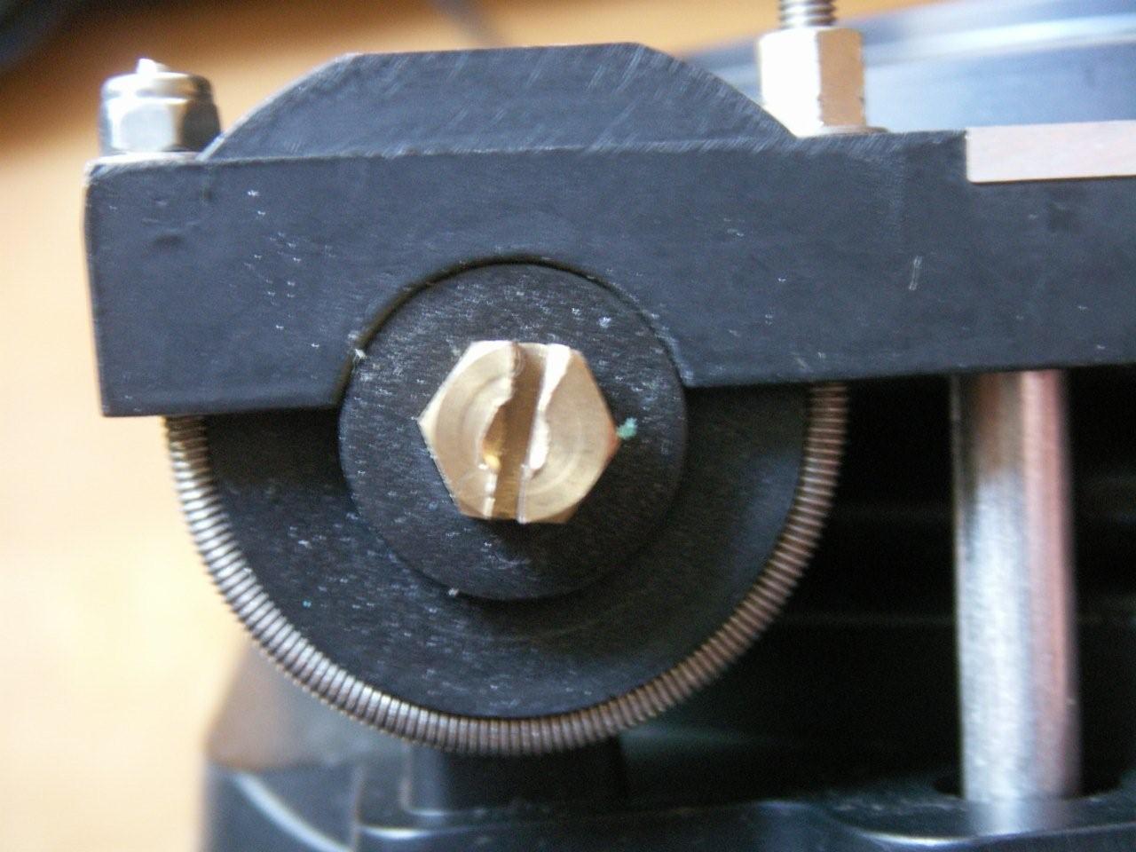

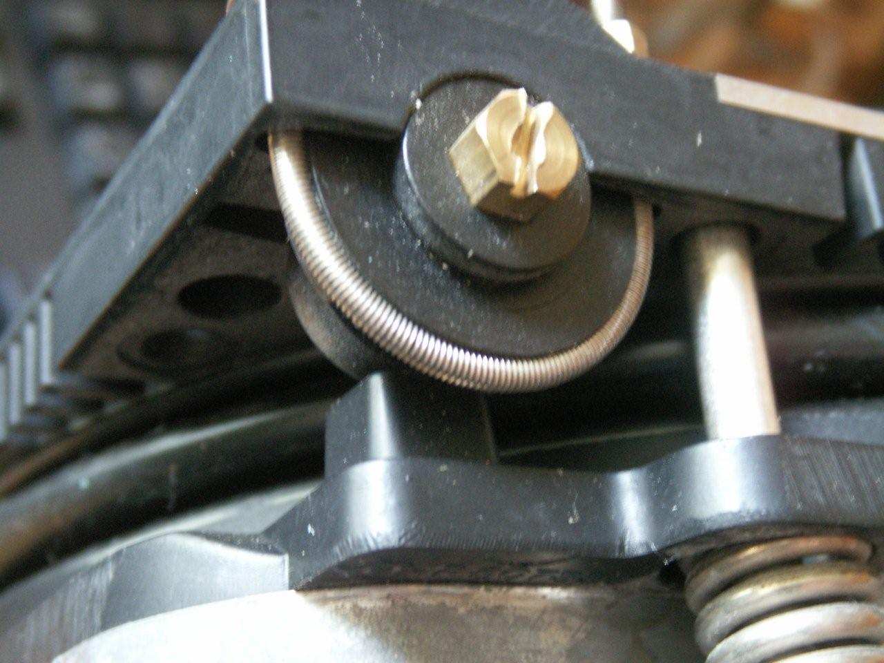

Let me explain a little more with a picture. Sometimes the screws are loose, but the thread on the U still grips the 'axle'. This can also result in movement in one direction only, locking in the other direction.

Mr. r.bauer is giving you very good advice, this is exactly how they work, and it
can be quite frustrating to work with in the dark trying to push the one micronut
with one hand and adjust with the other.....
Excess torque on the 8mm hex adjustment can separate the metal hub
from the plastic cam. Which won't be much fun to repair.

I have seen once that the brass 8mm brass hex was not fully inserted in the plastic, and when I turned it, it just fell right out. Just push it in a little deeper into the plastic, and it will stay there. i hav enever had to use glue on any.
Movement in one direction only, and not beeing caused by the U-shaped threaded rod locking the mechanism is a new one for me.
