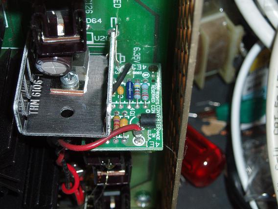

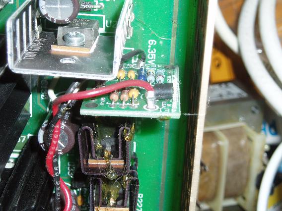

For today I planned to mod the LVPS....potentiometer and the 2 papst fans...BUT...
Looking at the potentiometer....there wasn't any...
Instead there is a small pcb....and I think this should be a full controlled regulator (perhaps with a slow (RC) start of the filament voltage)
Does anyone recognize this board?
I will check the voltage to see how/if it's working correctly after the fan replacement

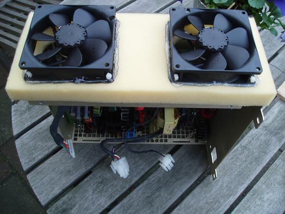

While waiting on ananswer for the question....I continued with the fans...(and some hot-glue...doesnt look nice...but it works Wink )

Posted: Sun Sep 28, 2008 4:17 pm    Post subject:
you have the Ultra version LVPS, no mod needed.
Arno P
Joined: 01 Jan 2007
Posts: 282
Posted: Sun Sep 28, 2008 4:31 pm    Post subject:
Very Happy Me happy....THX Wink

Posted: Sun Sep 28, 2008 7:24 pm    Post subject:
how much of a difference did you notice in how quiet the pj runs ?
Arno P
Joined: 01 Jan 2007
Posts: 282
Posted: Mon Sep 29, 2008 6:09 pm    Post subject:
That much difference that I don't hear the 2 lvps fansanymore.....BUT now I notice the belly fans again Mr. Green Wink
"Obviously you're not a golfer"
