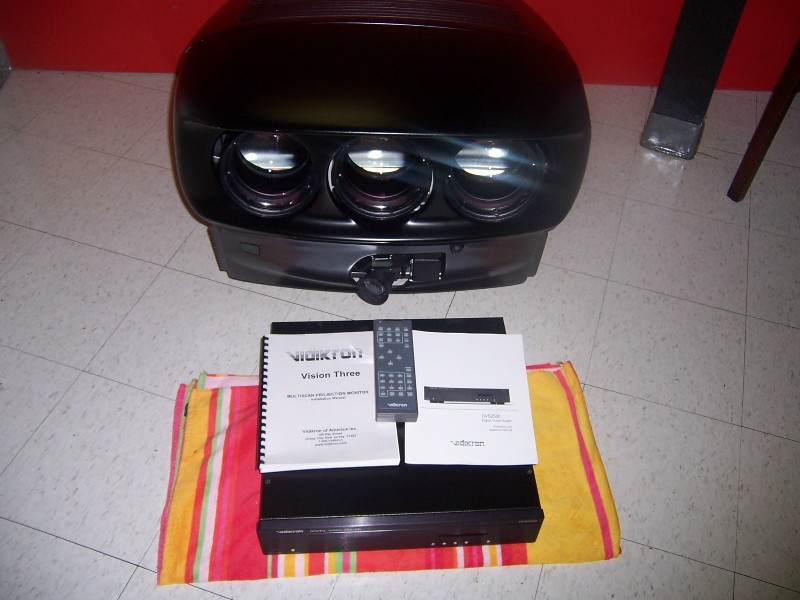

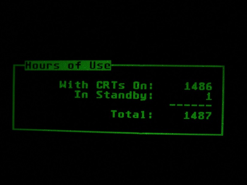

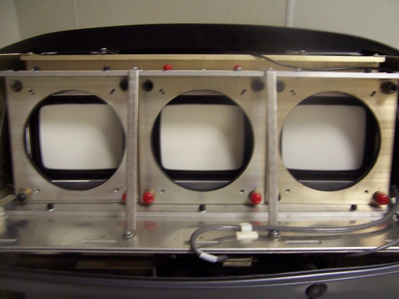

Nick purchased the PJ from me. This Vision3 has less than 1500 original hours on it and it is totally stock. Nick did not pay a premium price for the PJ. I am the second owner and I never did end up installing this PJ as I lucked into a deal on a G90 a couple of years back shortly after. Curt would have this PJ listed at $3K or better and likely so. I mean, after all, he IS CURT PALME for cryin' out loud. Very Happy I sold it for less than a third of that. I'll let Nick post a price if he wants. I did not sell the unit with a warranty, but you can damn well be sure that if the PJ turns up with any issues when being set up that are not user related, I'll make sure that Nick is not left hung out to dry. I'm as fair as they come so it won't be an issue. I hate to see it go as the sleek and cool Vision case is what made me dream of having one years ago but I need to clear things out to prepare for a stack. I love the look of the Visions and the thing is damn near silent compared to the G90. It should ship out on Tuesday and be in his possession by Friday so he can post back when it arrives.
Draganm, please advise Nick on anything that you think is a MUST with this unit as I do not have the knowledge to do so. If after hearing your suggestions, Nick has second thoughts, then I have no problem sending him his money back. I want him to be happy and I think that he will.
Doc
