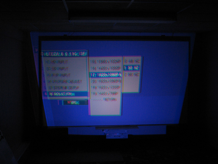

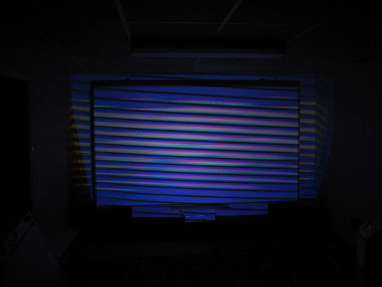

So, did a bit more testing tonight and took some quick shots of the PJ up on screen.
1060p @ 60Hz - scrambled video, Unrecognized Signal
1060p @ 50Hz - locked video, Unrecognized Signal (need to add this mode, then would be fine)
So it seems as though a 50Hz refresh is OK, but 60Hz causes problem. Judging by the specs and comments posted, this should not be the case.
I know that there is ongoing investigation and no certain answer but, if this is 'scrambled mess', what causes this?

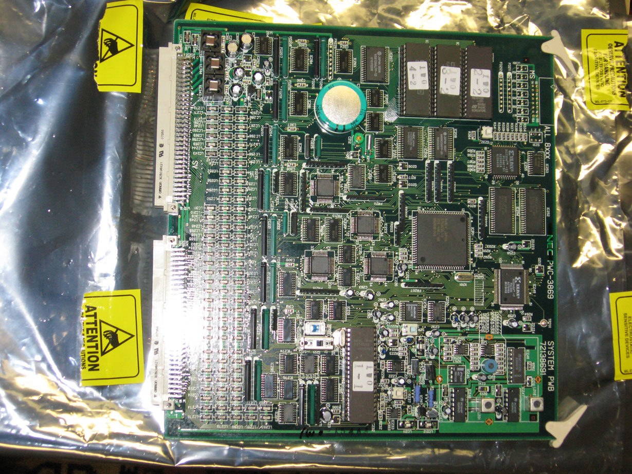

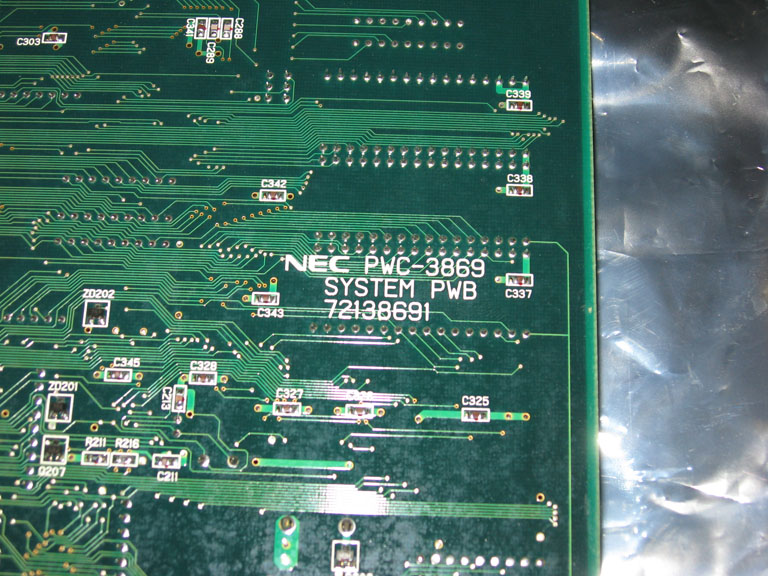

Also, I added a snapshot of both sides of my system board. I believe this is a 9PG board.
I'd like to get to the bottom of this, not necessarily because I want to run 1080p, but because I want to be able to see what it looks like and decide what modes are best. Plus, if the PJ is working in all modes I know it is rock solid.

Have you tried to vary the output from your scaler at all ? Are there any adjustments you can make to it ?
That doesn't look like the typical "scrambled mess" to me, and if you get visible menus with the signal connected, then it pretty much isn't the typical "scrambled mess"...

I would guess a wrong board like others have suggested already.
