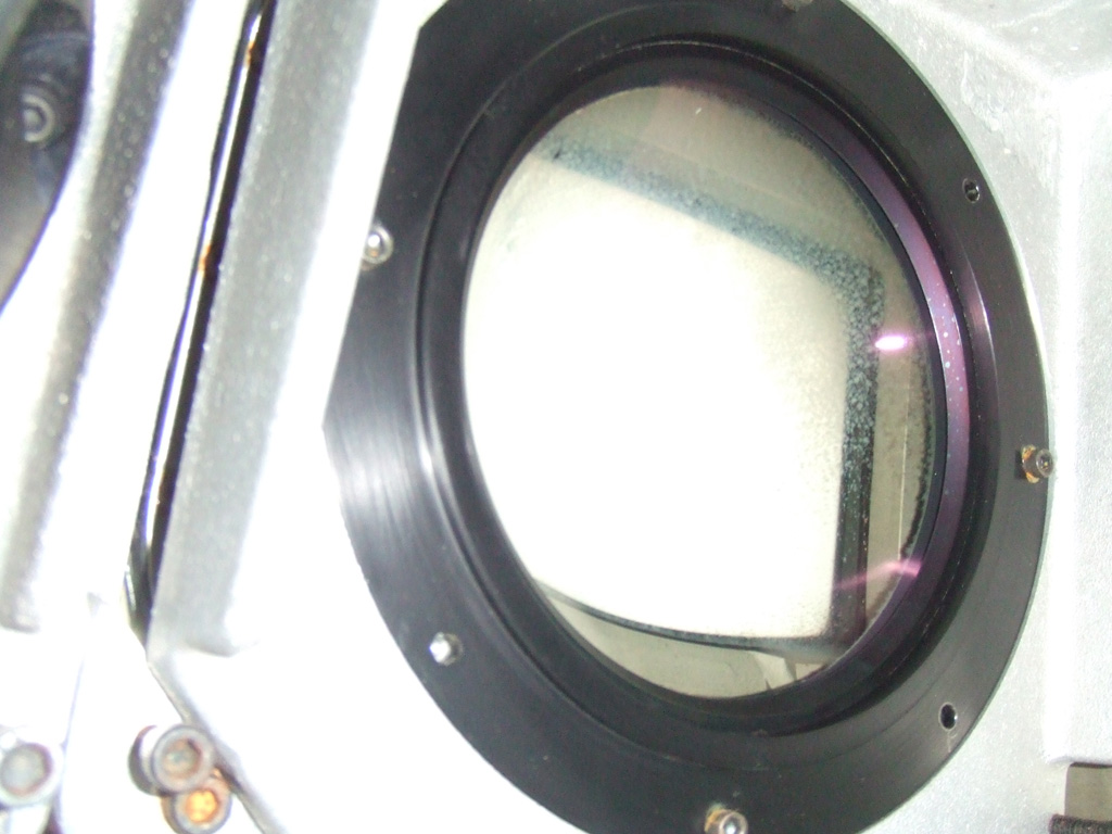

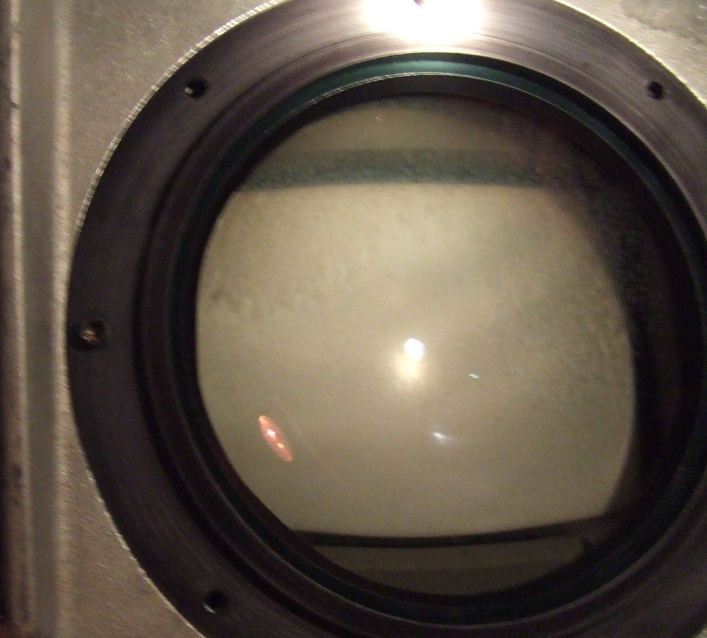

I think I figured it out, looking inside the lens I found the FUNGUS..... DAMMIT!!! See attached pics
Now WTF do I do?
This sucks.....

Posted: Wed Aug 27, 2008 4:17 am    Post subject:
Not sure how handy you are but I would start be talking to Terry, he sold you the set and may be willing to give you a hand as after the sales service.
Posted: Wed Aug 27, 2008 4:28 am    Post subject:
You have to flush out the Glycol and put in new stuff. To do that you need to remove it with a syringe, and then flush it out and refill with new glycol, getting it out take awhile and flushing would be a pain if you try to do it through the tiny screw holes. Removing the C-element is the best way but very time consuming and you must be careful not ti rip or tear the Bellow or your screwed and have ot send it to VDC for a replacement and cleaning, about 500 bucks.
Look over my Bellow removal post and see if its up your ally, but be careful !
https://www.curtpalme.com/forum_archived/viewtopic.php@t=12094.html
