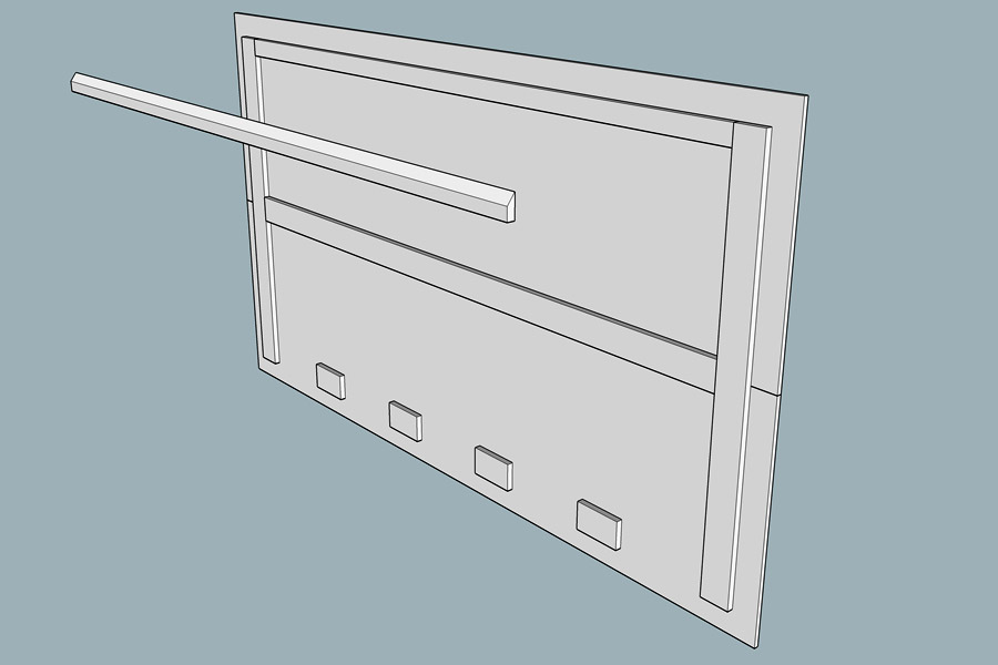

My screen is a little bigger/heavier than what you'd have to build. Yours could just be the two halves of MDF, plus a 1x4 to attach the seam, another 1x4 at the top for a cleat, and another 1x4 at the bottom (or even just a few chunks) to hold the screen out at the bottom.
Also, the laminate came oversize, and generally, you use a laminate trimmer - basically a router with a special bit - to trim the excess laminate off. It leaves a nice clean edge you could paint and cover with trim, or just leave some extra trim hanging over to hide the edge.
The way I did it is by no means the only way - just one way.
Attached is a screen like mine, but with 1x4 and no material waste (assuming the extra MDF could be used for shelving, etc.).
This consists only of (2) 4x8 sheets 1/2" MDF and (3) 8' 1x4's (Plus screws, liquid nails, contact cement, laminate, etc.)
Screen with French cleat and 1x4...

You can also rent a saw from a tool rental shop (or Home Depot) for a day for probably $10. Might make sense if you won't have any other need for a $100 saw laying around for years to come. You'll also need an aluminum saw guide and a couple of little clamps. The saw guide is extruded aluminum, in two halves that snap together, and is about 98" or so when assembled. Using it, you can get a super-nice perfectly straight cut the entire length of a 4x8 sheet. Without it... not so much.
So on the diagram you posted, is the top 1x4 board running the length of the MDF piece the 2nd half of the French cleat?

Those are cool looking drawings there SC. Is that Google Sketchup or what?
"Coffee is for Closers."
Posted: Sat Aug 23, 2008 12:54 am    Post subject:
Yes and yes.
I LOVE SketchUp. I can't build anything any more without building it in SketchUp first. I'm totally addicted.
