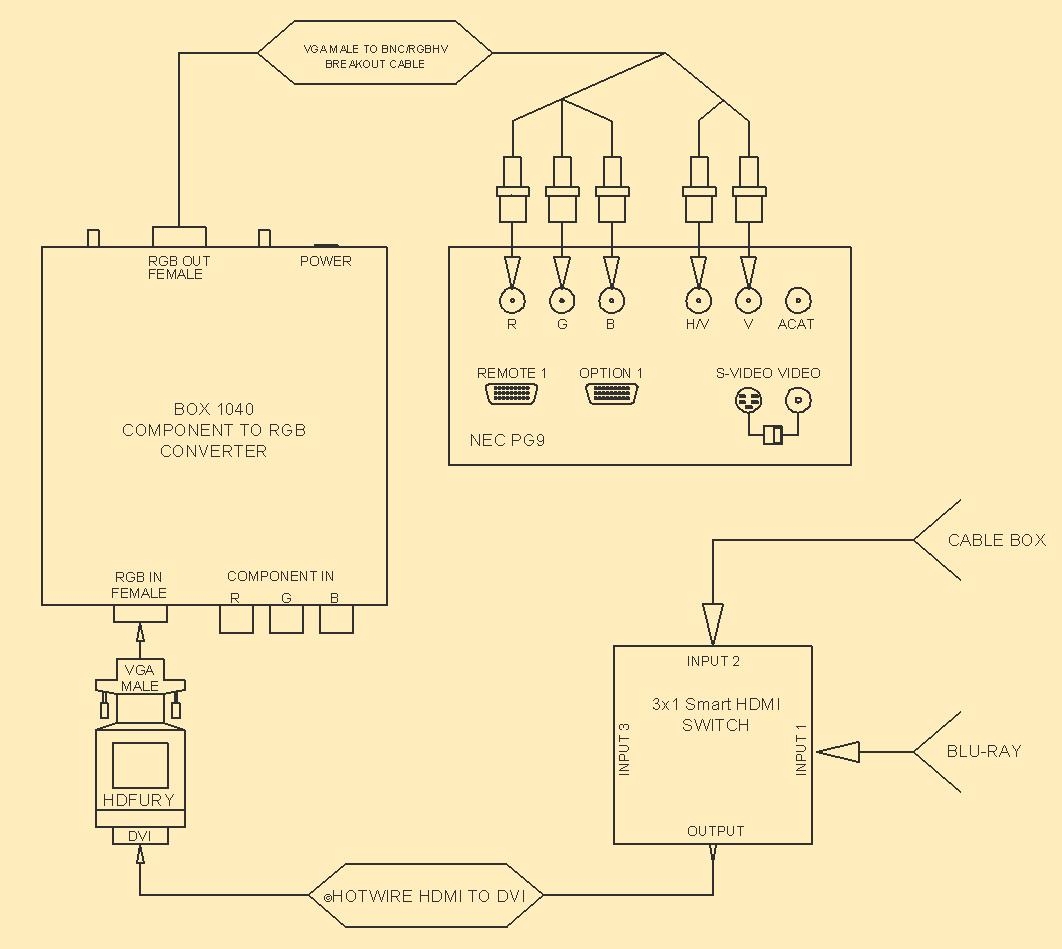

Could one of you experts check my work? This is what I'm planning to do to hook up my PJ, I just wanted to confirm that I'm on the right track. Thanks

Posted: Thu Aug 14, 2008 4:52 pm    Post subject:
looks good to me.
Posted: Thu Aug 14, 2008 5:12 pm    Post subject:
Looks fine
Posted: Fri Aug 15, 2008 3:03 am    Post subject:
Don't see any problems either.

Posted: Fri Aug 15, 2008 9:07 am    Post subject:
Being ignorant, what is the 1040 providing? Do you have a Component video source, or is it allowing something like Gamma control?
Posted: Fri Aug 15, 2008 11:57 am    Post subject:
Wanman, see: http://www.curtpalme.com/Box1040.shtm

Are you asking because it didn't work or do you just want to know before trying?
The Box 1040 and RTC2200 seem to do exactly the same thing. Is one better than the other?
