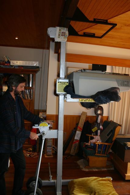

thanks for any help, I unfortunately have many more questions...I have included some pics of the 1271 going up to the unique ceiling mount...

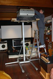

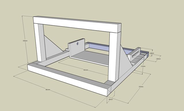

Thanks for the replies. I have added some more shots of the projector going up and the mount design that I had to come up with for our ceiling type....

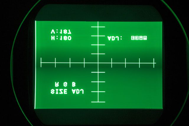

the centered rasters and centered video input, show the same results...the projector may be parallel to the screen, but it is not centre!! ...even though the measurements from corners to screen reveal that it should be squared up. Time to move the screen, at least I have enough wall space.
Embarassed
At least I'm getting a full raster size without reaching max settings:
 Filesize:  26.45 KB
 Viewed:  6629 Time(s)

If the test pattern is truly centered on the tube face, the source (whether internal or external) is irrelevant. There's no reason at physical install stage, you need to use any external source.
Wayne... If you've only measured to the corners and haven't done any right-angle (orthogonal) projection, the projector could absolutely be out of square AND not centered, but the measurements to the corners could still be equal. You MUST find the orthogonal projection from the screen - just measuring corners won't find that. Otherwise, you'll have both horizontal keystone as well as horizontal focus issues.
Do you or a friend have a laser level you could use? By far the most accurate method to ensure the projector is nice and square to the screen is this:
Find the center of the screen and translate that to the ceiling at the wall/ceiling intersection point (use a spirit level or the laser level). Then, using a tape measure and the 3/4/5 method (or a little basic trig) and a mechanical pencil (you can use painter's tape if you don't want to make marks on the ceiling), find a point on the ceiling - say 8' from the screen. On the screen you have screen center marked at top and bottom (and center, too - you'll need to do geometry, anyway). Then, set up a laser level on a tripod close to the projector, but well in front of it, a meter or 1.5 off the floor. In "plumb" mode (vertical orientation), you can then strike a laser line right up screen-center, across the ceiling, and across the projector chassis. That will then be the perfectly orthogonal projection. If the projector is mounted square and centered, the laser line will strike right through the center of the green lens (or tube face), right across the center of the chassis, and will land right between two metal tabs on the remote IR sensor at the back of the chassis. Any error in mounting of more than a few mm will be immediately obvious, as will <1 degree of rotation.
I have my projector square and centered down to within a few millimeters using that method. At that point, any pattern, regardless of external or internal, will be on the center of the screen if it's on the center of the tube face - period. The number (whether 115, 127, or 140) becomes irrelevant.

Looking at your picture, you may also want to note that while you have the raster squared up center on your tube face, that the internal "centering" pattern quite obviously is NOT in the center of the tube face. I see 4 major divisions left and right of the center-line. But there's significantly more extra space on the right side than the left (10 more pixels, in my gfx program, where the total pattern portion width is 382 wide). Of course the projected image will be off-center on-screen. Although I doubt the full 10cm deviation you're seeing will be explained.
If you mark the physical centerline on your CRT face (say with a thread), then ANY pattern, internal or external, can be aligned to that point. Only after doing that should you come to any conclusions about how far off center your on-screen image is.
