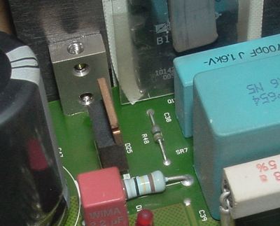

You mentioned EHT boards, did I miss something? You need to have the quadrupler and the EHT (R7627165), right?
Just took the EHT board out and found that it only had a very light fit, it literally fell off as soon as I removed the screws...
Is this normal?
And I noticed that one edge of the thermal layer is bent under and touches one leg of the component (btw. what exactly is this, a thyristor?) mounted to the heatsink.
Even though those things are non-conductive (at least I hope so) would this be able to disturb signal flow?
Regards
Carsten
 Filesize:  24.83 KB
 Viewed:  9934 Time(s)
Heaven doesn't want me and hell is afraid I'll take over.
Posted: Sat Aug 09, 2008 4:15 pm    Post subject:
That's what I need, yes. If the board was screwed down, then the contacts are fine, same with the thermal layer. THis is some fault on the board or quadrupler. I'll figure it out..Smile
