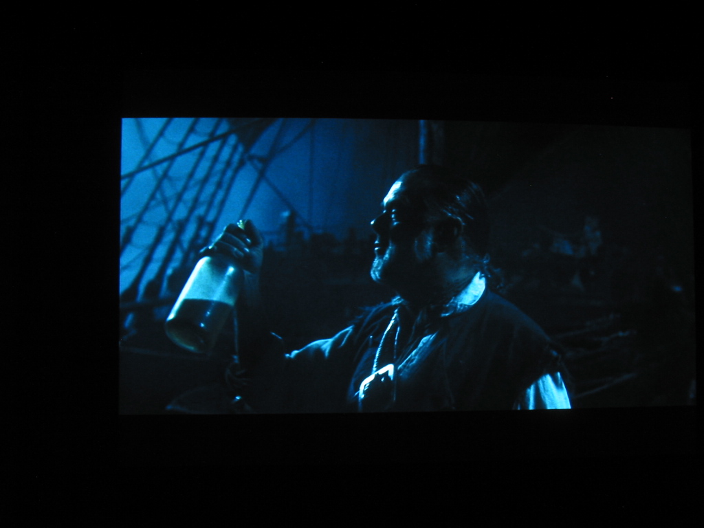

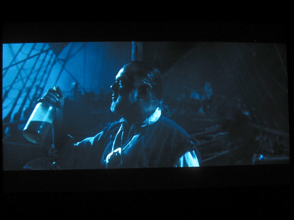

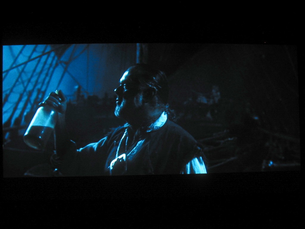

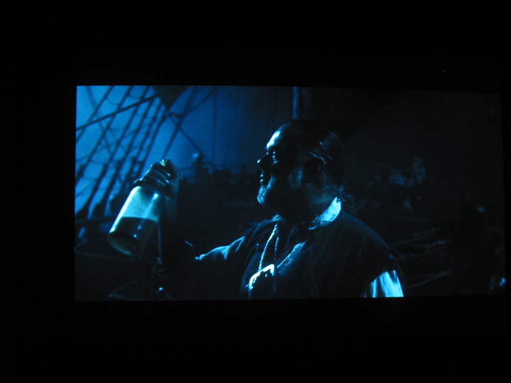

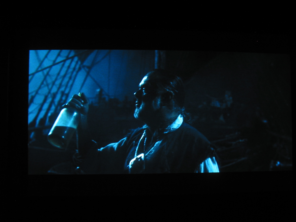

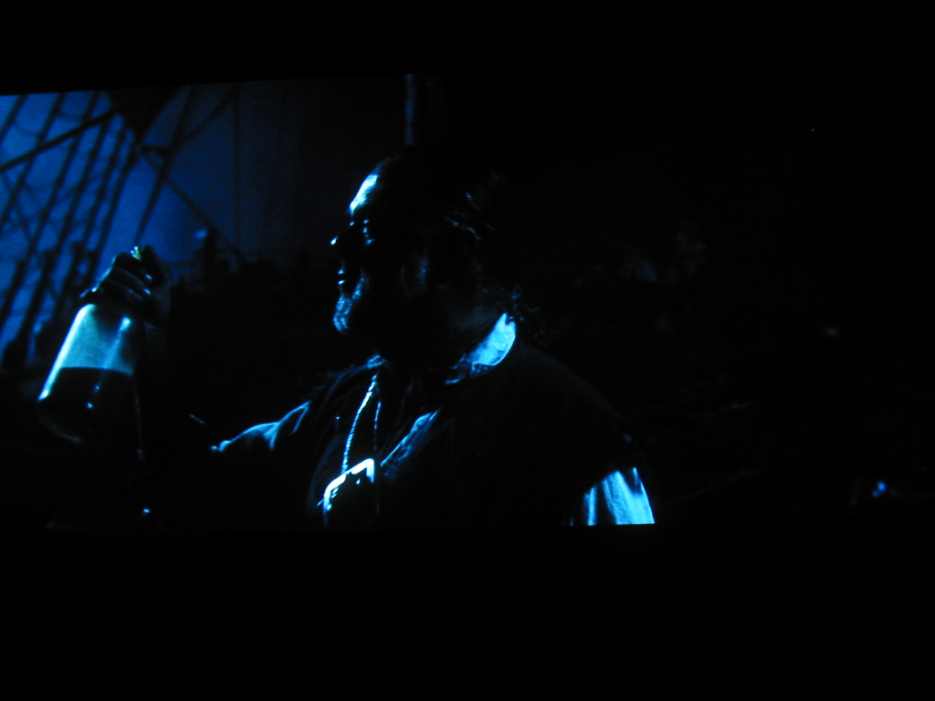

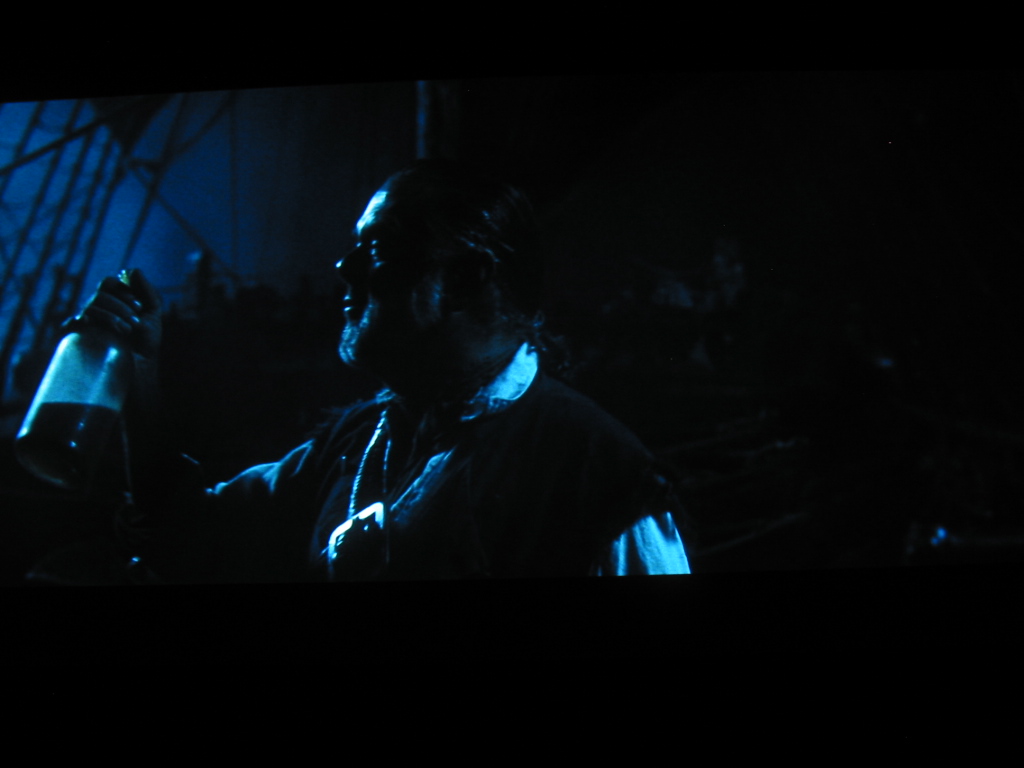

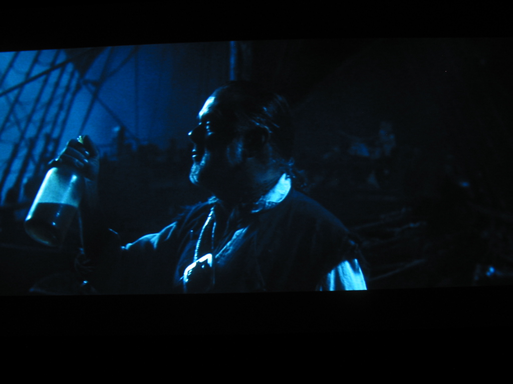

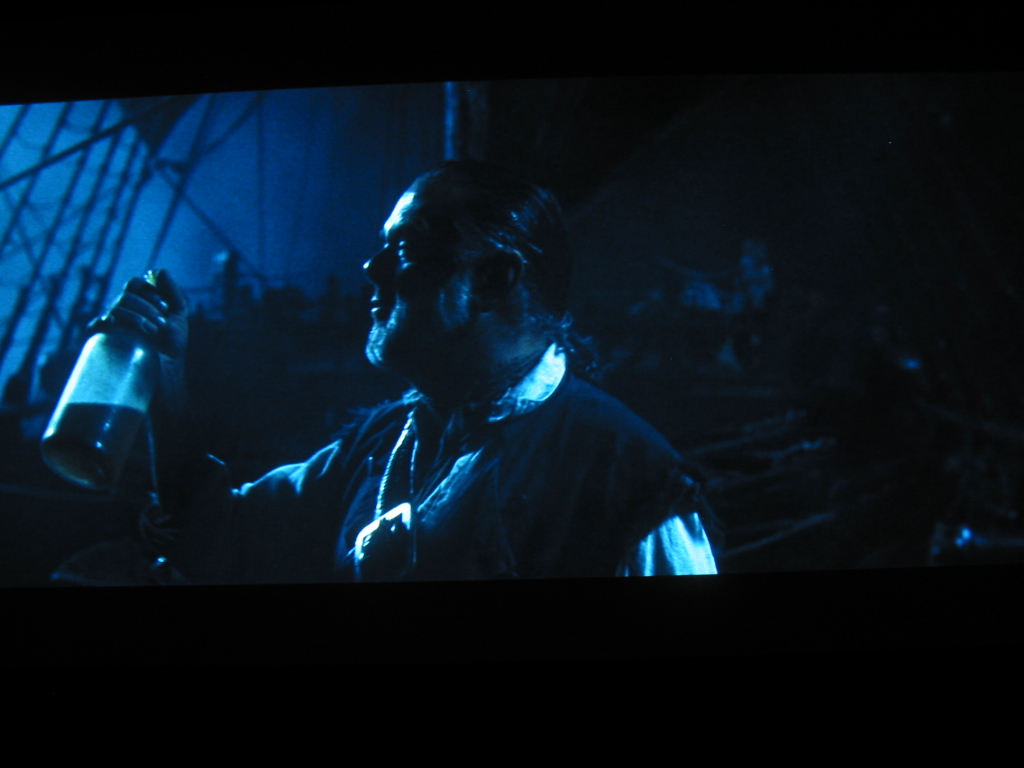

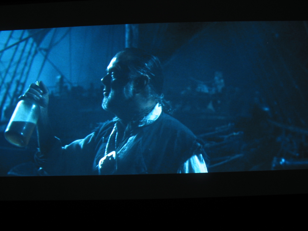

I loaded up Pirates 2 on the HTPC and just stuck to one scene. The first screen shots are analog.
The second screen shot's are HDFury connected to Box1020
The third screen shot's are HDFury and Extron 202
See the screen shot titles for details.
HTPC at 1080P/60
ATi 3850
Bluray drive
POTC 2
HDFury
Box 1020
Extron 202+ w. RGBHV external interface
box
Analog direct to monitor NO GAMMA
Brightness 30. Too dark, unwatchable on a dark film.
 Filesize:  126.9 KB
 Viewed:  15436 Time(s)
Brightness 44. THis is where I usually bump the brightness to on a film
 Filesize:  166.74 KB

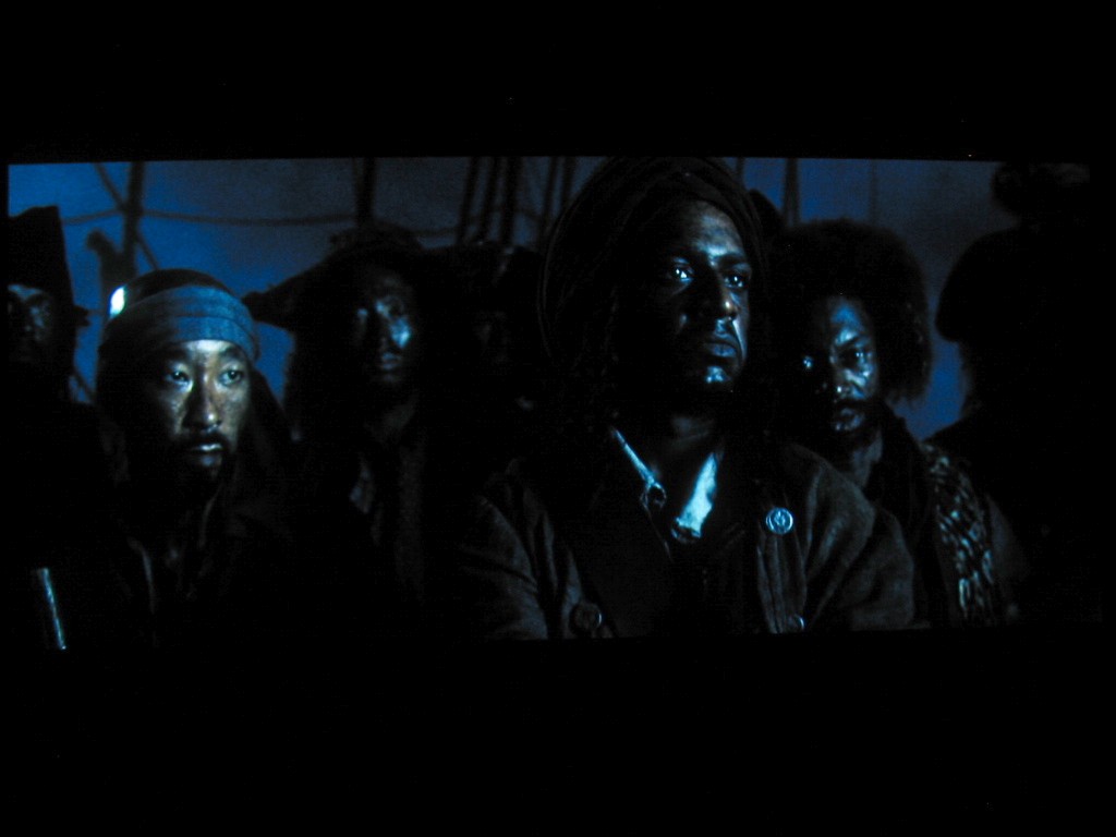

HDFury/Box 1020 Gamma OFF at Brightness 30. Also too dark to watch.
 Filesize:  94.88 KB
HDFury/Box 1020 Gamma ON at Brightness 30. Now, very watchable. Lot's of shadow detail.
 Filesize:  106.14 KB
HDFury/Box1020 Gamma OFF at brighness 44. Watchable but looses shadow details
 Filesize:  184.36 KB
HDFury with Extron 202+ at Brightness 30. Little dark again.
 Filesize:  141.07 KB
HD Fury with Extron 202+ at brightness 44. Way too brite. Extron's level controls cranked.
 Filesize:  209.54 KB

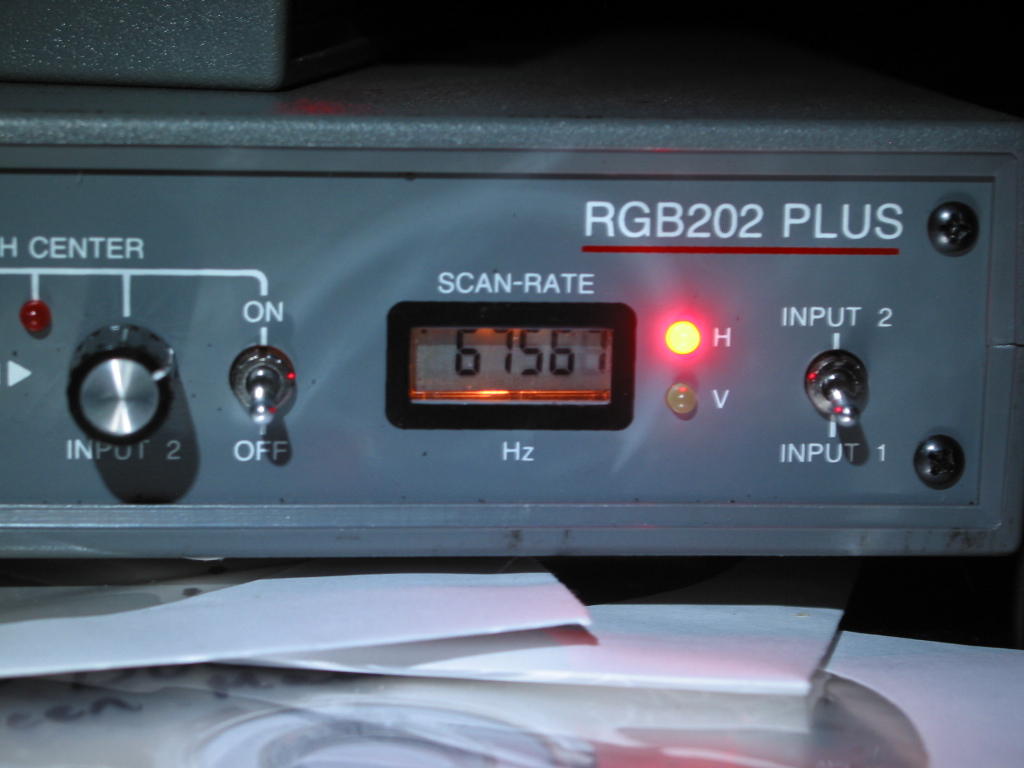

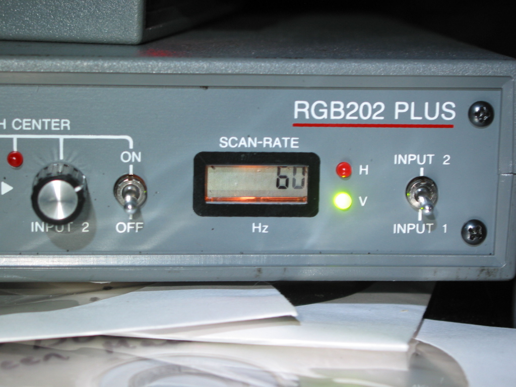

Extron 202+ Vertical scan rate 1080P/60
 Filesize:  277.49 KB
Extron horizontal scan rate 1080p/60
 Filesize:  251.53 KB

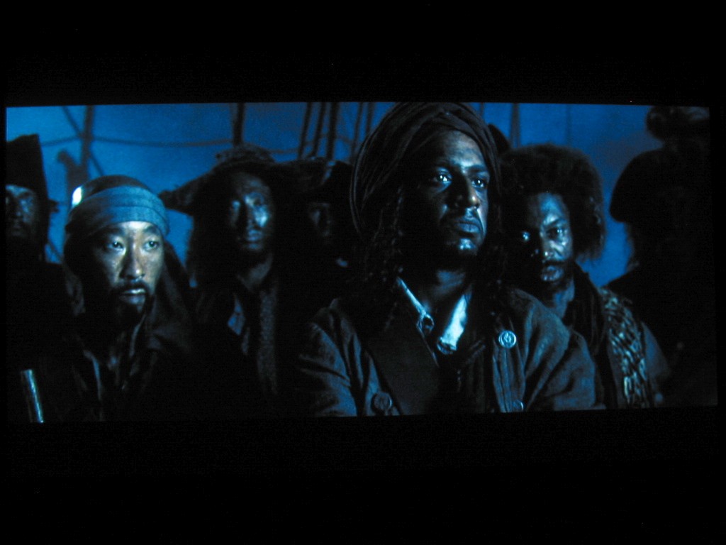

I'm guessing the VPH50 can do a better job than the HDFury/Box 1020 combo but hey here's a couple more screen shot's just because.
HDFury/Box1020 gamma off.
 Filesize:  68.94 KB
 Viewed:  15433 Time(s)
HDFury/Box1020 with gamma on.
 Filesize:  102.03 KB

Wow,
Thank you so much! Kal should make this a sticky, as it really shows what gamma can do.
It it does look like the Extron can handle the 1080p... When you said you cranked up the controls on the extron, what controls are there....
On the DVDO I have gamma control over Red, Green and Blue seperatly.... So I hope I have enuf....
I think the Extron may be the way to go... Now do you want to sell yours ??? Smile Smile
The BOX is nice, but I just hate the cable conversion.... RGV DSub from Fury to BOX, Then DSub-Breakout Cable to RGBHV cables to PJ.. Mabey it's all in my head, but I would 'think' there would be some signal loss... Thats why I wish Moome's EXT-HD's would have worked....
This is a EXCELLENT comparison and seems to prove you dont need 1ghz of bandwidth....

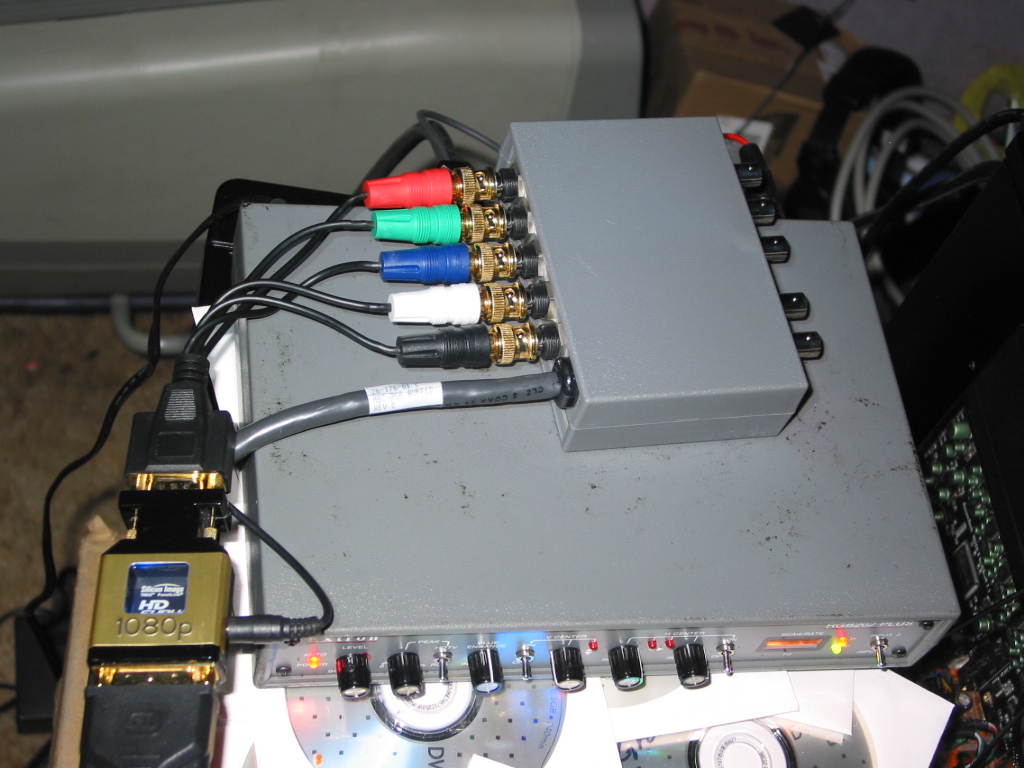

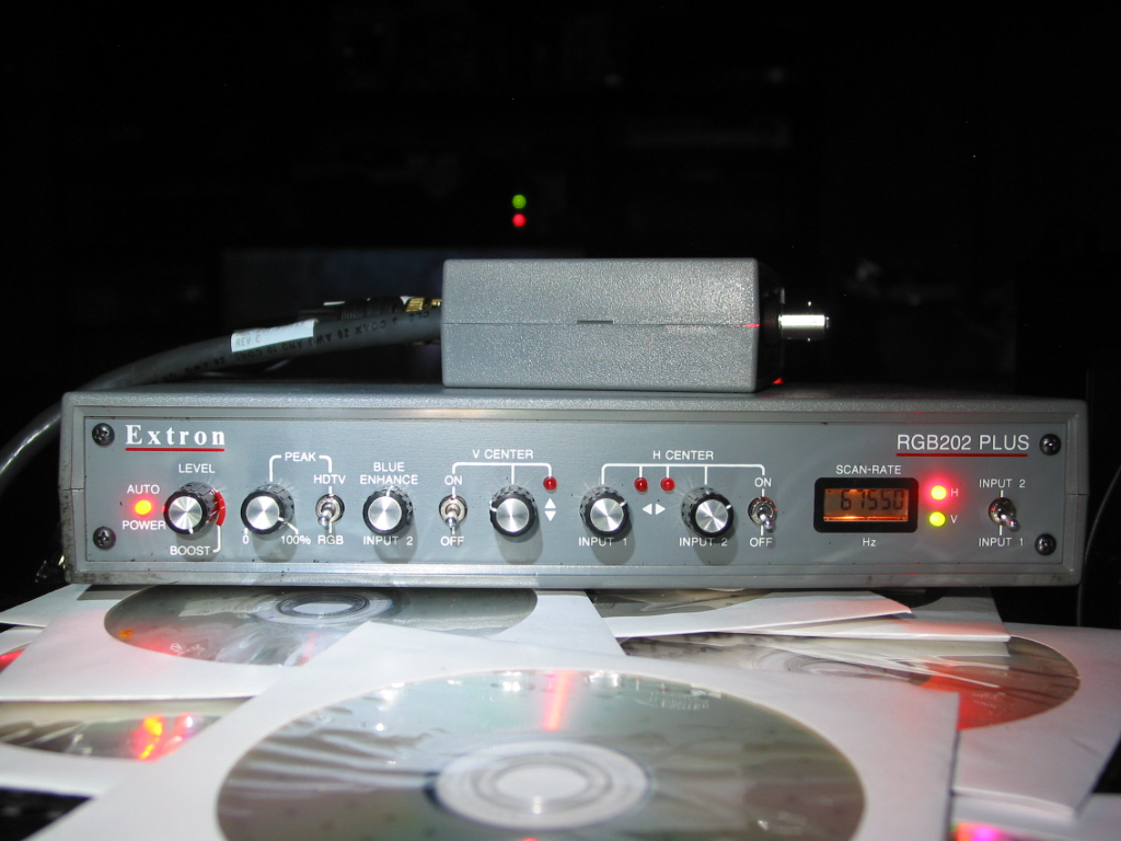

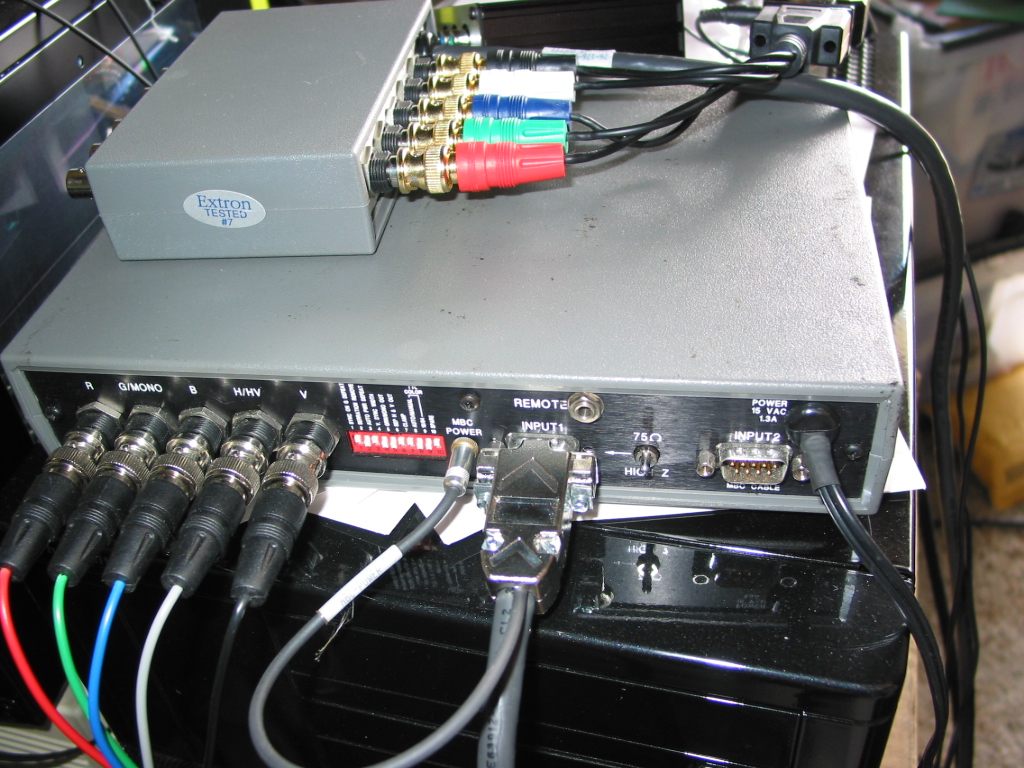

Nope mines not for sale. I actually bouhgt it to use as an output stage from my PC-1271 switcher when I use a moome card in it. The DVI and HDMI inputs on the moome cards don't put out enough voltage to drive my Ampro. The analog Component side was fine ( analog good!, digital sucks lol )
This Extron box also corects horizontal and vertical shift. I used to to centre the picture from the HDFury. You can see how far you can shift the picture in the three shot's below. The camera was locked off on a tripod. I just turned the H centre knob and moved it over.
Keep in mind you are doing a cable conversion with an Extron box. The input is a DB9. You can either make a custom BNC to DB9 cable or buy the breakout box like I have. I was fortunate to get all the goodies with mine. THe ouput on the Exton is BNC.
Extron 202+ rear view W/HDFury connected
 Filesize:  409.77 KB
 Viewed:  15408 Time(s)
Extron 202+
 Filesize:  264.52 KB
