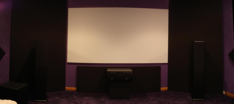

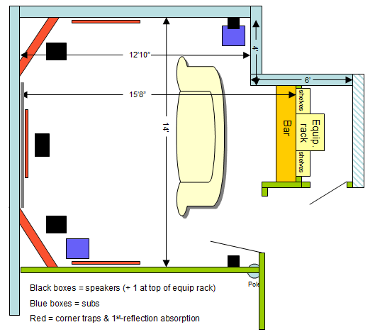

You know, I built some major sound-treatment panels for my HT shortly after I built it: huge 4'x8' panels of 4" OC703 rigid fiberglass behind L & R, and 2" of OC703 mounted 2" off the wall behind the center and on both side 1st-reflection points. See diagram & pic below. I expected major improvements in dialog intelligibility and other areas. In reality I hardly noticed any change at all. It may have been because of the low-end Onkyo HTIB speakers I was using, but I was pretty disappointed.
So maybe room treatments only give major benefits if you already have pretty darn good speakers?

The answer to this question probably lies in these forums but I will ask anyway. Is there a simple method for determining the size and placement sound panels? In my limited searches on the matter, theories seem to vary quite a bit.

I can say, without a doubt, that acoustic treatments made a HUGE difference in my room. I had Mark Seaton come down and tell me where to place the treatments. One of the most improvements gained was from hanging three panels on the ceiling in front of the screen. Most people don't think about this location and if it wasn't for Mark, I wouldn't have either. Mark arrived on a Friday night, popped in to tell me where to hang the panels I had made, and then headed back out. I hung the panels that night. Mark came back the next day and spent about 6 hours fine tuning the system. When it was all said and done, I could not believe the difference. It was like having an entirely new system. My wife even noticed the difference!!!!! Thumbs Up Mark had told me that I had all the pieces to the puzzle in the room but I just wasn't using them correctly.
I STRONGLY recommend having someone come out and do an audio calibration if you want a major upgrade without actually uprgrading ANYTHING!!!
For what it is worth, Mark Seaton is a very stand up guy, loves what he does to the point of getting a grin on his face when he reaches BEYOND what you thought your system was capable of, and is reasonable in price.

Gary, how's your hearing? I'm only half joking. Obviously, the better the speakers, the more difference the room treatments will reveal. Also, the level at which you typically listen will have an effect. If you don't crank it up much, you won't expose as much of the room reverb. As for dialog intelligibility... If you're using discrete surround, most of the dialog will come from the center... and none of your treatments would have that much audible effect on the center center channel. Now that you have your new speakers, I bet if you listened for a month, get used to the sound, then took out those side panels, you would notice a significant difference in how much more articulate and crisp the sound is with the panels in place - stuff like plucked strings, foot steps, drum rim shots...
It isn't so much that the opinions vary (although there are some differing opinions), it's that it really depends what you're trying to do. The easiest and simplest acoustic problem you can fix is to tame first reflections. You can use the mirror method... sit in your listening position and have somebody slide a mirror around until you see the speaker... that's your first reflection point. If you're handy with the computer, you can also use the FRV software to visualize first reflections. There's a thread on it on AVS. There are also a lot of threads on acoustic treatment there.
