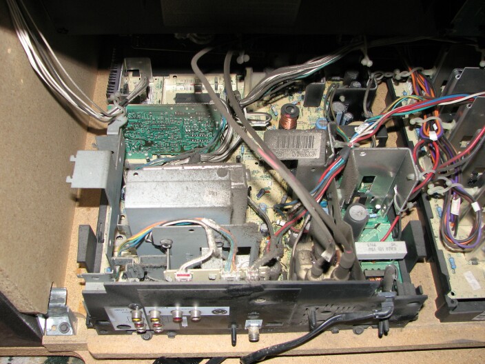

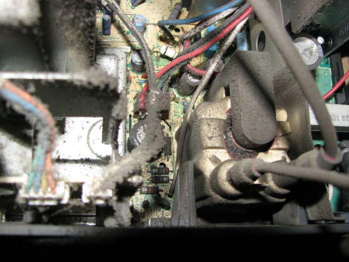

Posted: Tue Jul 29, 2008 5:44 pm    Post subject:
macgyver655 wrote:
I would like to see a pic of that burn on the fly.
Thanks for the tips MacGyver. Here's some pics. I know, I know, it looks like the TV's made of cardboard.

Posted: Tue Jul 29, 2008 5:55 pm    Post subject:
Step 1: Air compressor used liberally.
Step 2: Check HOT for shorts (transistor mounted on that large heatsink behind and to the right of the flyback.
rpruen
Joined: 07 Apr 2008
Posts: 67
Location: Southwest UK
TV/Projector: BD701 FTS, BD808s
Posted: Tue Jul 29, 2008 6:40 pm    Post subject:
Yes, get the dust out of there.
Also be carefull with the HV, that tube will hold charge much longer than a projector tube. Maybe for a few min if the flyback is fitted with a discharge resistor, or several hours if not!
That isn't likely to be a problem now, but once you start testing, take care to discharge HV before getting too close.
HV can be discharged as follows... Connect a cable to the ground on the TV, such as the frame, or ground wire from the tube (easy if it is the braid type). The other end of the wire goes to a thin screwdriver, obviously make sure the wire is in contact with the metal part. You then feed the end of the driver under the edge of the HT cap on the tube (keep fingers clear), untill it toches the contact. The screwdriver is grounded, so any voltage will jump to it, not travel through you. If the tube has any charge then you will hear a snap, but once the screwdriver touches the contact, you know *for sure* that it is safe.
I didn't do this once, I was in a hurry, and still have the burn on my finger.
