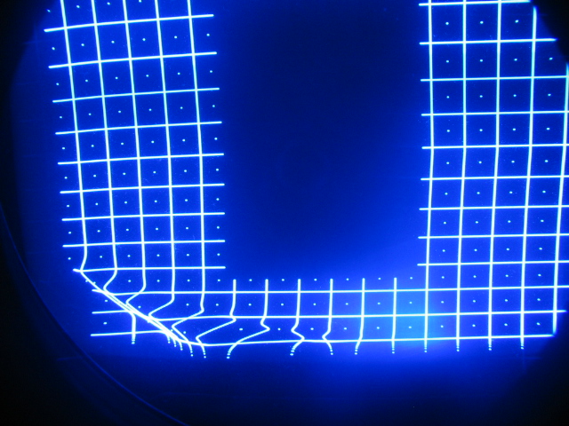

I just got this projector and have been able to set the convergence on this except the left side is giving me an issue. It is floor mounted front projection. First I can't get the bow out of the left side, it bow in toward center. not bad but you can tell. but major issue is the blue in the upper left corner is all wavy. I can straighten out a little but can't remove it completely. I am a newby so hopefully it's an easy fix.

You might need a new convergence board. Post a pix of the test grid please so we can see what you're talking about. I've had this on a few Barcos, have never been able to find the cure, but swapping the convergence board does the trick.

Posted: Sun Jul 27, 2008 2:32 pm    Post subject: picture of convergence issue
Here is a picture, thanks Aaron

That typically is a bad convergence board assembly. I've seen a few like this, never found a real cure for it. Swap another board set into it, problem gone. Take your board and put it into another set, and sometimes it will work fine in that other set.
Send it up for me to test/repair/swap. It's some kind of component failure on that board.
