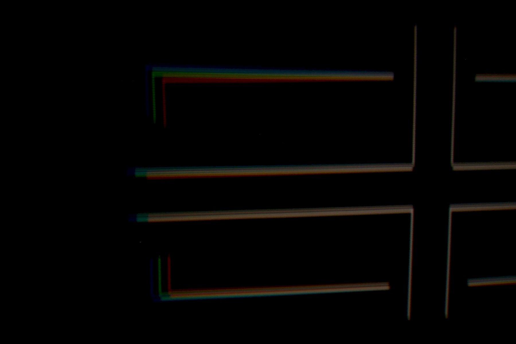

Please see the picture below. Need help with the alignment of the RGB on the right and left side. Center seems to be OK. Please give an much detail as possible. Thanks.[/img]

Do you have the setup remote? HAve you downloaded the manual? This is a case of you needing to work through it very slowly. THe engineers that wrote the software for the PRO 900 were on crack; it's one of the more complicated sets to attack, but working through it carefully will get you there.
Your pix is of the basic test pattern in the onscreen menus. you need to get into the service menu with the service remote and follow the manual step by step. Figure on 3-4 hours before you get good at it..
