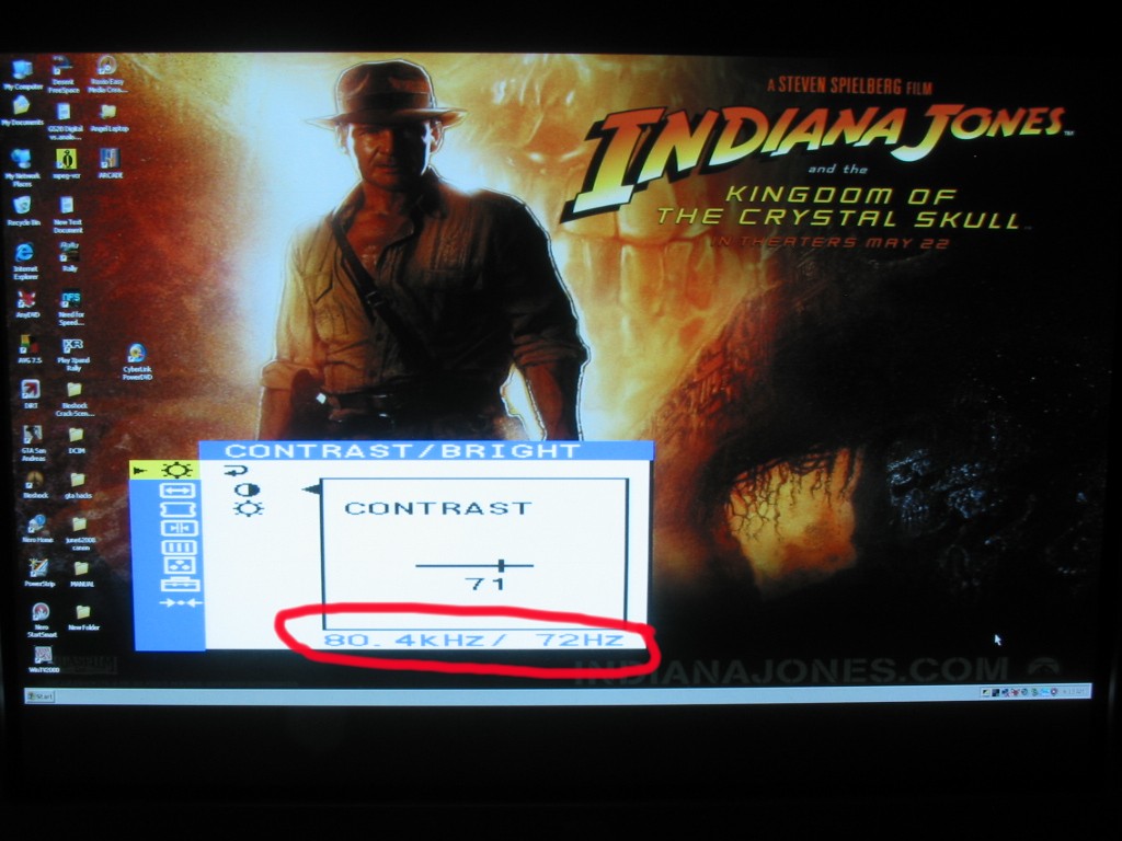

Posted: Sun Jul 27, 2008 8:13 am    Post subject:
ilias wrote:
I think the HD-FURY not support the 75Hz!! Who's answer to this? Curt?
I don't know if it will go 75Hz but it will do 1080P at 72Hz.

Actually I have an Ampro 4000 but that screen shot was from my Sony G520P 21" CRT monitor. I love the on screen clock rate display.
