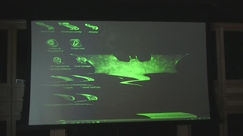

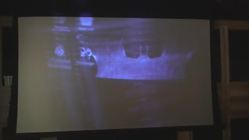

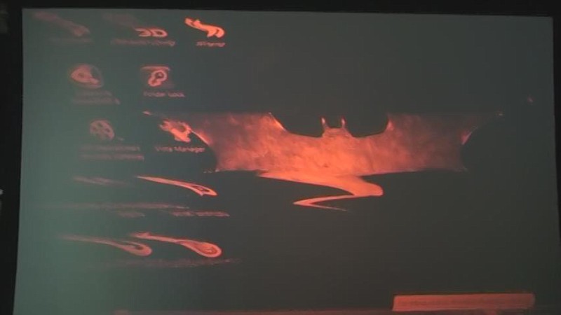

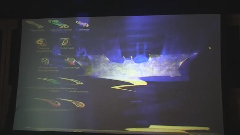

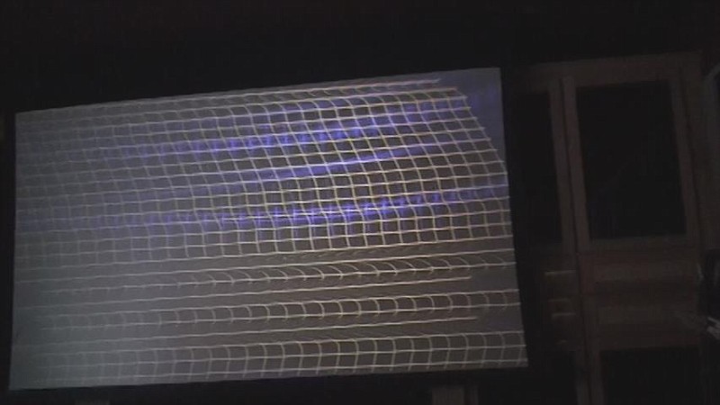

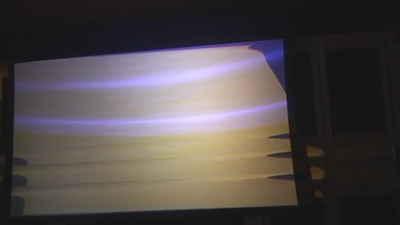

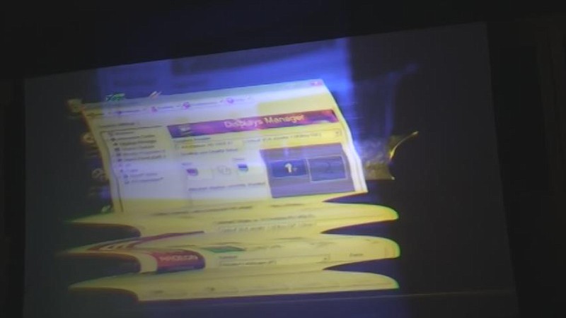

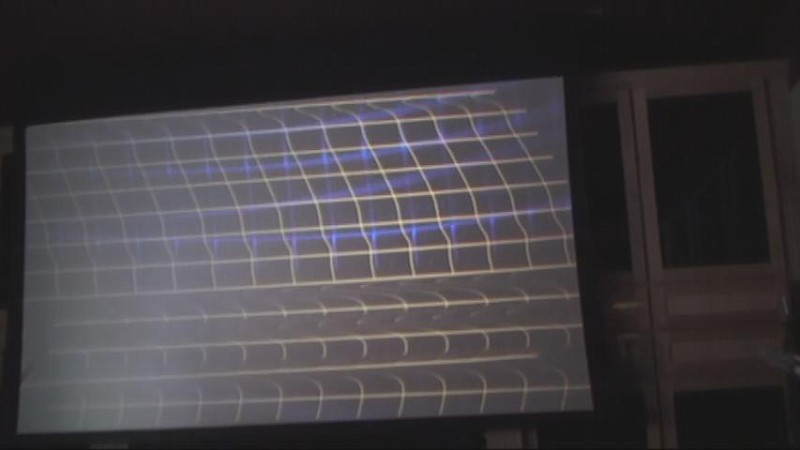

With this set up, I was able to watch 2 Bluray disc in one day. The next day, it powered up but after 10 minutes, it went dark. No visible light output on the tubes what so ever. The green menu wont even come up. I though, oh no, its the HVPS again. After 30 minutess of powering up and down, the M8000 came back to life. This time, the picture was all screwed up. The red and green tubes seem to be doing the same thing, but the blue was showing a totally different picture.
Please check out the screenshots below. I isolated the RGB by pulling the power out of the junction box that powers the individual CRT. What do you guys this is wrong with my M8000? Is it worth repairing?

The room was not totally dark at the time I took the picture.

Picture was a screenshot of the video tape I took.

All three CRTs.

Guessing phase, signal lock related problem, but it is very unusual for it to affect the internal patterns too...
Posted: Wed Jul 09, 2008 12:25 pm    Post subject:
Yeah weird, its definitely a Horizontal issue as the horizontal lines are still nice and straight. Maybe the HDM or a bad CLM or one that needs its chips cleaned and reseated. Unless its one of the source devises like the HD Fury causing an Issue.
Posted: Wed Jul 09, 2008 1:48 pm    Post subject:
INteresting problem. Disconnect the ribbon cable between the convergence board and the motherboard and see if it goes away. I'd suspect the CLM or the HDM.

I forgot to mention one little tiny detail. Smile After 30 minutes of total darkness, I powered it up again and saw some smoke coming out of the front. That was when I started getting the genie picture. Sorry I could not pinpoint exactly where it was coming from.
The distorted crosshatch pictures were with all inputs disconnected.

Anyway update, I tried firing it up again. This time no more picture or the green menu. The "hfail" diagnostic red LED on the CLM is now lit. I did swapped the CLM from my spare machine. its the same thing. Same "hfail" light and still no picture.
Thanks,
Raymond
Posted: Thu Jul 10, 2008 1:36 am    Post subject:
HDM

I do have a spare machine. The all three CRT tubes are in perfect condition so I was saving it for that. However, over the years, I did harvest the HDM, VNB and HVPS out of my spare pj. Anyway update, I tried firing it up again. This time no more picture or the green menu. The "hfail" diagnostic red LED on the CLM is now lit. I did swapped the CLM from my spare machine. its the same thing. Same "hfail" light and still no picture.
Thanks,
Raymond
if you have 3 perfect tubes then your choices are clear IMO. Send them to someone who can install the tubes into an 8500 with all the necessary tech service bulletins done to it.You will be stepping up both in pic quality and reliability. This swap shouldn't cost you more than $700. + return freight to you IMO . Of course if your technically inclined you could do it all yourself too. An 8500 with perfect tubes is a really good place to add a Moome HDMI internal expansion card for killer HD through Blue Ray or whatever.
Oh and if your 8000 has killed more than one HDM in a few thousand hours then I would suspect the LVPS (low voltage supply) has drifted on the 85VDC rail. This is adjustable with a trim pot in the back but a little bit PITA to do.
