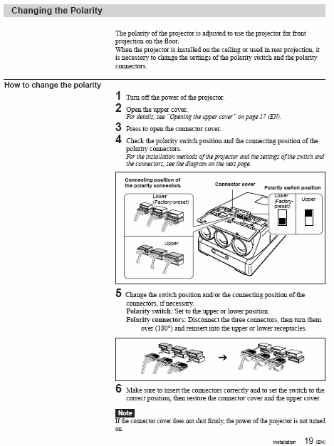

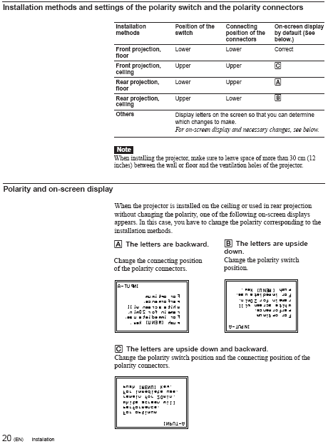

How make the picture upside down in SONY G70 for ceiling? there no info in the manual!!

Download this manual http://www.curtpalme.com/docs/SonyG70_Install.pdf And then look at Changing The Polarity in the manual Smile

Yes there is, if you look in the right manual. Page 19-20 of the Installation Manual:

Yes I found it! thank you very match my friends for your help!!!! I have an error 37 for the FAN and replace all 3 with the SilenX but don't work at all! I am waiting the tachnician to bring an other fan from some BARCO!
