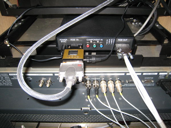

Having a hard time explaining this connection progression.
If you can take a photo showing the HDMI-DVI cable to the HDFury attached to the Crescendo RTC2200 with output connection to projector I would appreciate it. Thanks in advance. Doug

Here!

I'm curious why you have the HDfury and RT2200 sitting on top of the Barco instead of keeping them in the rack and then running a RGBHV line to the projector, is there less signal loss the way you wired it?
Erik
Gary M.
Posted: Fri Jun 27, 2008 7:06 am    Post subject:
Erik
best to keep analog cables short as possible, DVI/HDMI on the other hand can be ran for a long ways if you have a hot output device with plenty of juice on the HDMI output
-Gary

My problem was not being able to explain how to hook the HDFury into what he already had. Sometimes its easier just to send a photo like on this one. Many people dont know the connections and cant get a minds eye on how it all works. Actually they dont want to know but just want it to work.
