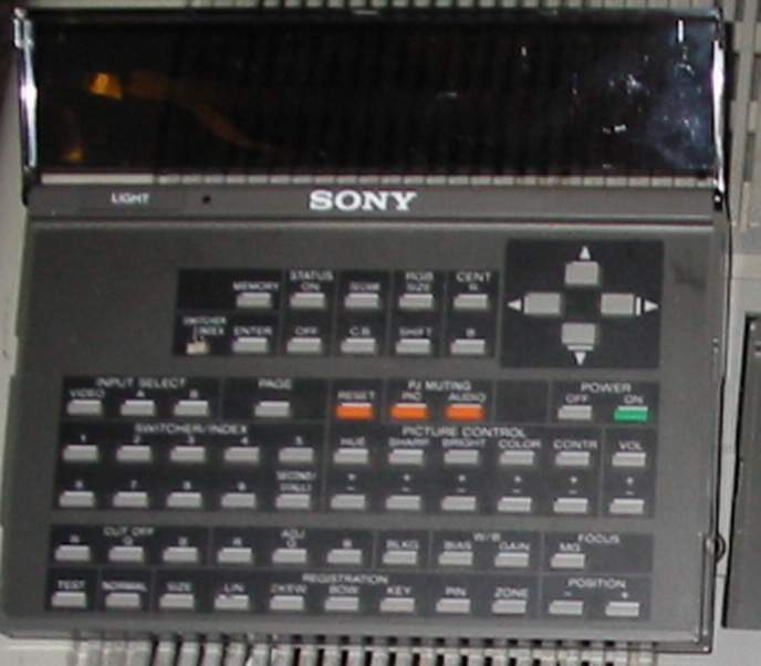

The remote that I sent you is for a 1292. Look on the back and you will see the 1292 designation and on the front it has the EM focus button for the 1292. The lower cover is from a 1271 so the number does not match, but I assure you it definitely is a 1292 remote. The 1292 remote will operate the 12xx projectors just fine. Have you tried new batteries yet? It may be that the receiver in your pj is not as sensitive as your buddies is. Here is a picture of it with the lower cover removed:
