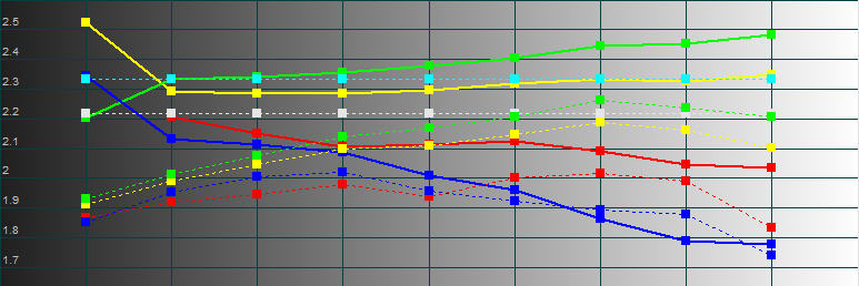

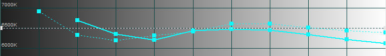

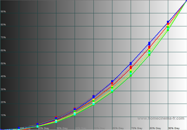

See attached pix. I've set up the Momitsu readings as the "reference," so they're dotted. The Luminance graph is a bit busy but it's clear the PS3 is darker, especially at low IREs. The Gamma graph shows significantly higher gamma (== darker display) for all colors, except high-IRE blues. The color temps are different but fairly similar. Note that the PS3 doesn't show a temp for 10%, apparently because it's too dark to read there.

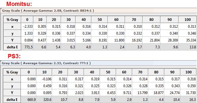

Finally, I've included the Momitsu & PS3 measurements. You can see the PS3's Y measurement (in cd/m^2, since I haven't figured out how to get Y to display in ftL) is much lower at low IREs -- in fact the 0% reading didn't register at all -- while the 100% reading is only about 10% low on the PS3.
