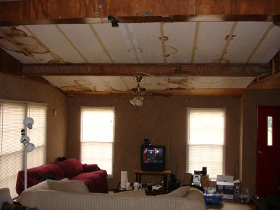

I just purchased a Barco 808s and I would like to mount it in the living room. The only problem is the vaulted celling. I am trying to mount the pj on the top of the vault, but I dont know what to do about the drop of the pj. The highest mount for the top of the screen is 86" and the top celling where the pj is to be mounted is 105".
Should I angle the screen to avoid over compensation of the key stone or just lower the pj? I want to do the unistrut install so I am not sure how much the unistrut will take up between the celling and the pj.
Its a mobile home so the vault is only 2 feet over the 14 feet of space.
Any ideas?
The pj can be as far back as 13' at the back of the pj
Thanks,
Adam[/img]

Lower the PJ.
You can look at pics of mine in my photo album. Mine is in a mobile home with the vaulted ceilings.

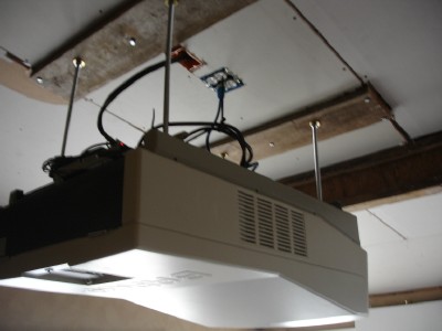

I have it up Ill post a pic. not like anything I have seen on here.

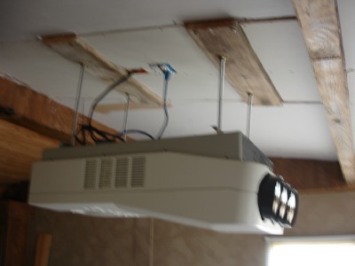

Here it is
I can hand on the pj and it will not move
I weigh 275Ib
10 5 in 9/16 lags
2 2x6
1/2 in all thread
lots nuts and washers
