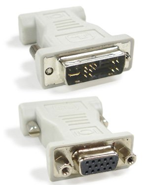

Didn't your video card come with one of these:

My 9600 came with that adapter, and it worked fine with a rgbhv breakout cable to my 1272. I had issues with getting the nvidia software in the pc to recognize the pj though.

I got a few extras it was an oem (I assume) and seems to have come lite from the guy that put the pc together (online purchase). No manuals or anything much cept a serial/registration card.
Not too sure if it actually came with one but I certainly have spares from my old rig which had 2x crts hooked up to DVI. Just couldn't tell from reading online if because it output to a VGA with adaptor (A) + DVI (D) that it was RGBHV compatible but it seems RGB and rGBHV are the same signal just the syncs are seperated physically.
