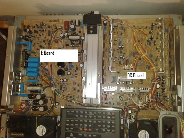

Posted: Sun Jan 04, 2009 12:05 am    Post subject: Sony VPH-12xx error code 2
02 means H-Stop 100v power down
You have said it worked for 10 mins then went all wonky this is the intermittent nature of a dry joint.
As another member has said, check the E board for dry joints on all transistors that bolt to the heat sinks down either side, you may have to remove the PCB from the metal work (a few multi plug nothing to bad) to gain access to some transistor legs as metal covers them up, leave the heatsinks attached to the PCB just handel with care.
The big long center heat sink with small 40mm fan is made up of 2 heatsinks held together with metal fan bracket one end and metal fixing at the other end, these need to be removed to aid PCB removal if that easier for you to do.
I recently had the same issue with my 1271 and it was a dry solder joint, every time I pressed the middle of the E PCB gently (with end of biro pen so it did not zap me) the PJ would fire up as soon as I let go it would come up with 02 error and shut down, easy repair if you can solder.
Also worth checking the DC board next to it as this also had lots of dark rings and cracks around the transistor legs solder joints.
This should cure it.
